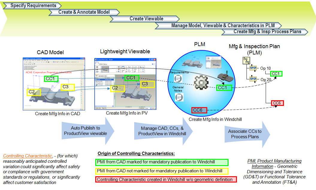

Build quality & inspection plans driven by the definition and management  of control characteristics

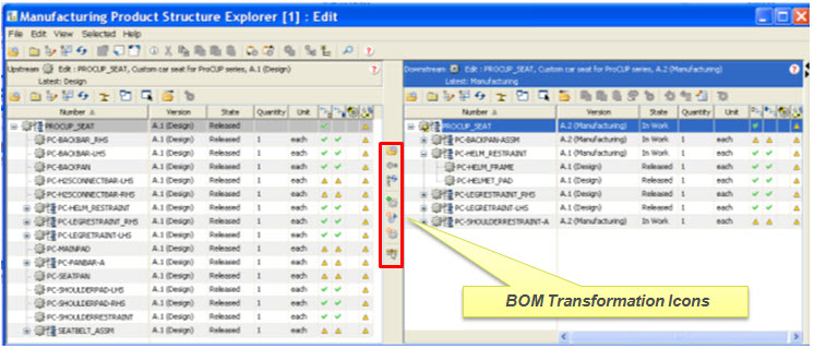

Streamline BOM transformation process with the introduction of a new “dual  structure editor” and new “shortcut” actions for most common tasks
In Windchill 10.0, improving the user experience is key.  One place where  that is evident is in the BOM transformation process.  In previous releases, the  user was required to go back and forth between 2 windows to perform the  transformation.  Now, a user is presented with a dual pane window that contains  both the upstream and downstream BOMs.  From that dual pane window, there is a  middle tool bar that allows you to perform a variety of actions between the  displayed BOMs.  This improvement has typically resulted in a reduction of 50%  mouse clicks and 50% mouse travel.
Dual Structure Editor

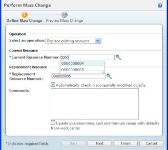

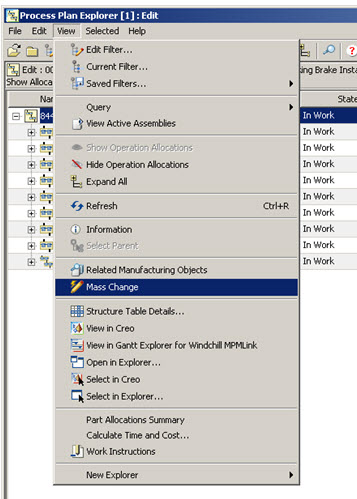

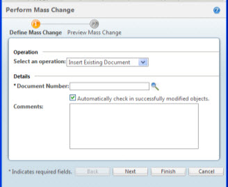

Mass Change support (documents and resources)
This new and powerful feature allows you to perform a mass replace of allocated resources on operations (processing resources and work centers).  In addition, you can perform a mass insert/remove of documents on MPMLink objects.
Mass Change from Process Plan Explorer
Mass Change Wizard
