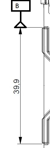

I just cant figure out how to add the geomtric tolerance reference to a dimension.
I guess there is a way.

By default, these are datum tags. You have to define them preferably in the model and show them as annotation in the drawing. Personally, I prefer to use symbols.
December 9, 2014
If you want to read up on these, you can see this discussion:
Drawings unstable in Creo 2.0?
On page 7 you will find my symbol for datum tags if you give up on the "right" way to use them.
http://communities.ptc.com/message/186109#186109
