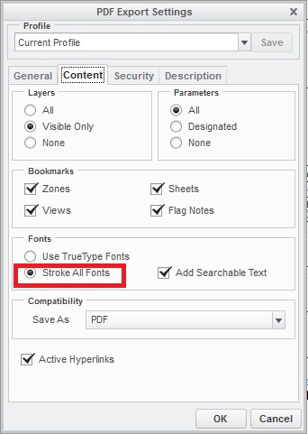

What i do, I take a PDF of the drawing (with Stroke all font options- this will let me search the text) and i search via PDF
i hope i answered your Question
rproux1-VisitorAuthor
July 6, 2016
Thank you for your response lokesh lokesh, but i don't find "PDF Export Settings" ?
For information, i work with the release 18.1.
July 6, 2016
I think not yet. For quite a long time an enhancement request has been placed in https://community.ptc.com/t5/Creo-Parametric-Ideas/Searchable-Viewables-PDF/idi-p/468752

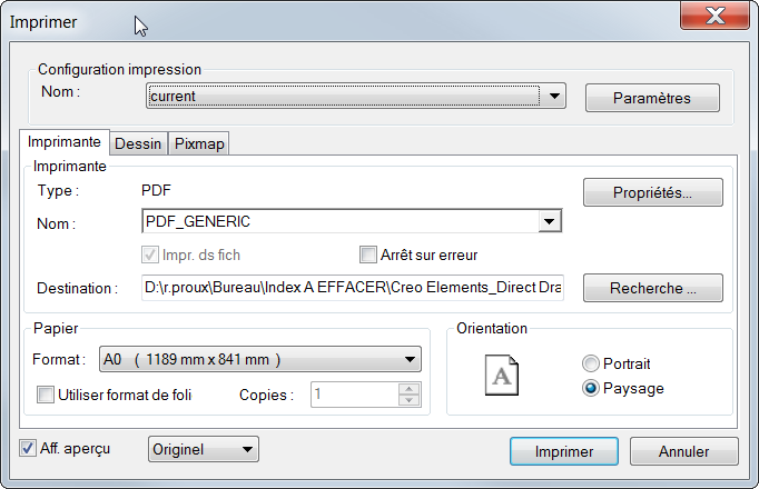

A search by "CTRL-F" is not possible.
As Friedhelm mentioned, a search via ME10 command language (Macro) is possible.
Also, a search for a text in a PDF generated by ME10 and/or Annotation is *not* possible, since the CAD application is "plotting"
text - and there is currently no setting to change this.
