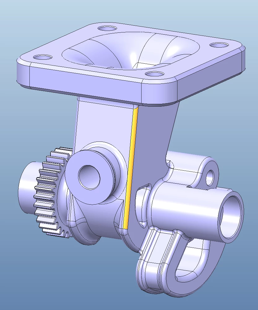

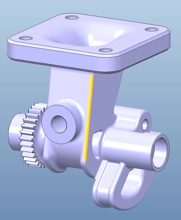

I can't understand why display of rounded edges are different on 2 Creo 2 installations.
On the first one, rounded edges are black, on the other one, they not appear.
Seems to be a config.pro option, but I don't see any difference.
Any advice ?

config.pro setting shade_with_edge_tangent ?
see this relevant discussion

Thanks very much.
That's what I was looking for...
