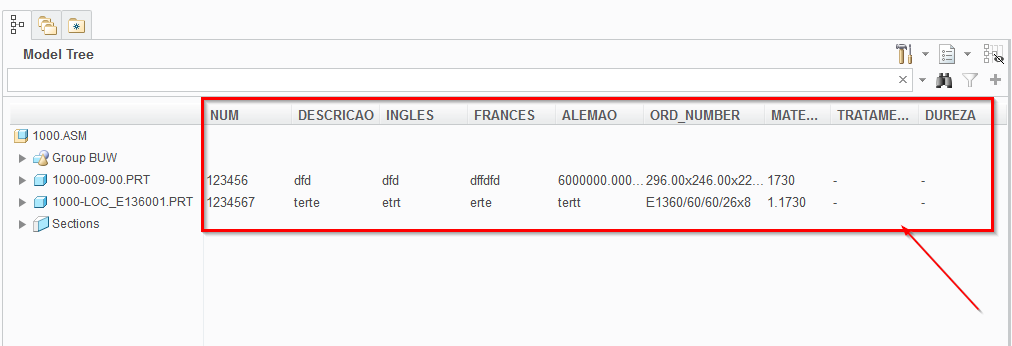

From what I understand, the values of the parameters will change from part to part.
Wouldn't be more easy if you add the parameters to the modeltree and fill them there?
Copy/paste there and little changes can be managed very fast.
