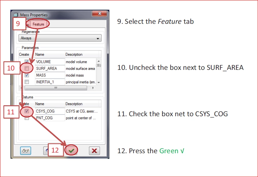

For Wildfire 4, the paramter is still MP_MASS, but this may not always be the best way to get the weight of the part. I used to use this in all of our start parts, but I found that sometimes you needed to regenerate your model once or twice to get the mass calculated properly. After searching around a bit, I found David Haigh's ProE Admin 101 presentation from the 2010 PTC/User conference and started using his suggeted method.
For this, you first assign a material to the part. Next, you create a mass properties feature in the model and move it to the footer (this way it is always the last feature to regenerate. You then add a parameter for your mass in the mass properties feature, assign it a unit, and add a relation (<new parameter="> = mass). You can then call this paramter in a drawing in the following: &<new paramter=">:FID_<mass properties=" feature=" name=">.
The benefit of this method is that no matter what units the model is set to, you will always get the same units out of the feature parameter as what you set the parameter to. So, for example, if you set the feature parameter to be MASS_KG and set the unit to kg, then even if the model was set to calculate weight in pounds, the MASS_KG parameter will always be in kg.
Attached is a copy of the instruction set that was created for the engineers in my department here, in case anyone is interested in a step-by-step process.
-Lawrence

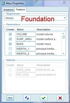

May 11, 2012
Hi Lawrence
I've just tried this in CRO1 and do not have access to #11 (see image below), it is greyed out. Not sure if it's CREO or licensing (Foundation License), but thought I'd ask here if anyone knows why?
Thanks for a great tip
Regards
David.

May 11, 2012
David,
Unfortunately I do not have access to a Creo 1 install at the moment, but I do have Creo 2.0 F001.
One thing you might want to check is that on the previous page, at step 7, you change the drop down from Quick to Feature. If this is not set, you will not be able to select the parameters you want accessible in the feature.

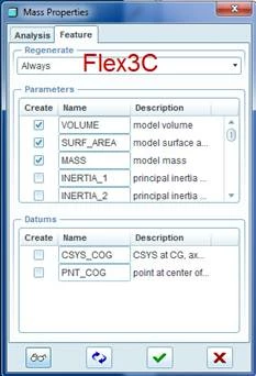

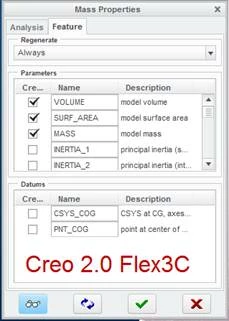

May 11, 2012
It is license related. A Foundation license will have the Datums selections grayed out when creating an Analysis, Mass Properties feature. A Flex3C (I know, that's not the name anymore but I still think of it that way) license allows the user to choose the options.
I don't know if it's something to do with the Advanced Assembly functions contained in the "fuller" license but we've always had to create the footer features using the Flex3C option
These images are from Wildfire 5.0
[cid:image003.jpg@01CD2F53.6AD4E2A0][cid:image005.jpg@01CD2F53.6AD4E2A0]
These are from Creo 2.0 (1.0 looks the same) - ditto there as well
[cid:image010.jpg@01CD2F53.6AD4E2A0]

May 11, 2012
Interesting, I just tested that here. We have 8 seats, 1 is Enterprise
SE (the old Flex3C), the others are Advanced XE + AAX, so we have AAX on
all seats. I cannot create those datums with our lesser licenses
either, but I can with the Enterprise SE seat.
So if it's not AAX, what is it?
