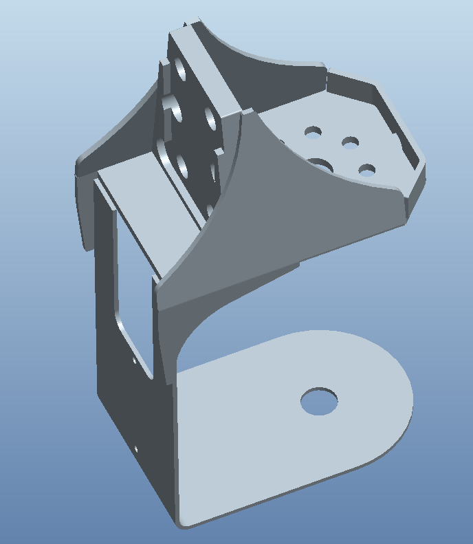

Hi
I am rater new to Creo Elements, using release 5 from 2009. On a regular basis, we need to do standard static analysis on welded details, such as the one shown on the screenshot. The heigth is about 360mm and weigth 4.4kg material steel. The item is fixed by bolts in the horizontal plates and load is applied at the boltholes in the vertical plate.Clipboard15.png
My question is, what is the best practice to build a FEM model based on an assembly?
I have considered the following issues by different methods:
  • The design might be changed so a new FEM model i required
  • It is nice to have the FEM model for a specific version of the assembly for later reference
  • preparing the FEM model from the assembly should be simple and not too time consuming

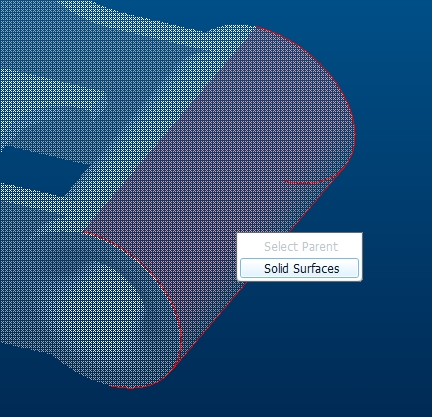

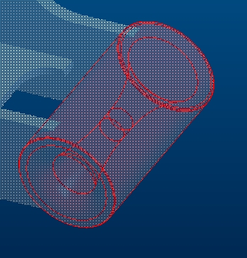

my method is without AAX:
  • STRG+C
  • STRG+V
  • ENTER
  • EDIT->SOLIDIFY... (Wildfire 5)
  • ENTER
  • STRG+A
regards
Paul
  • STRG+C
  • STRG+V
  • ENTER
  • ENTER
  • STRG+A
regards
Paul
