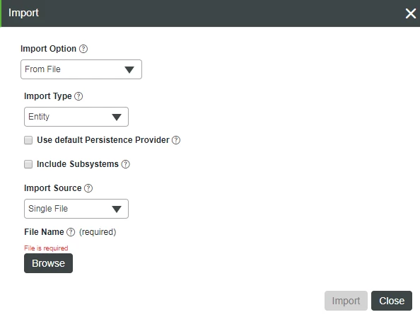

Import Demo Templates
  1. In ThingWorx Composer, click Import/Export menu, then click From File and browse to ../demo/edgedevice- demo/platform/entities/CPUDemo_AllEntities.xml
  2. Click Import then click Close when the import successful message is displayed.
  3. Create a new Thing using the imported template azureDemo1, enter a name for your Thing and click Save.

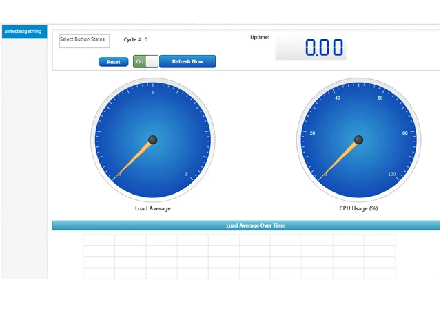

  3. Return to the ThingWorx Composer and open the Properties page of the Azure Thing that you created previously.
  4. Click the refresh button to see the properties change every five seconds.
  5. Open the azure-iot-demo Mashup and view the Load Average and CPU gauges, and the increases in the values of the Cycle and Uptime fields.
    NOTE: If the edgedevice-demo is running on Windows, the Load Average does not register.
