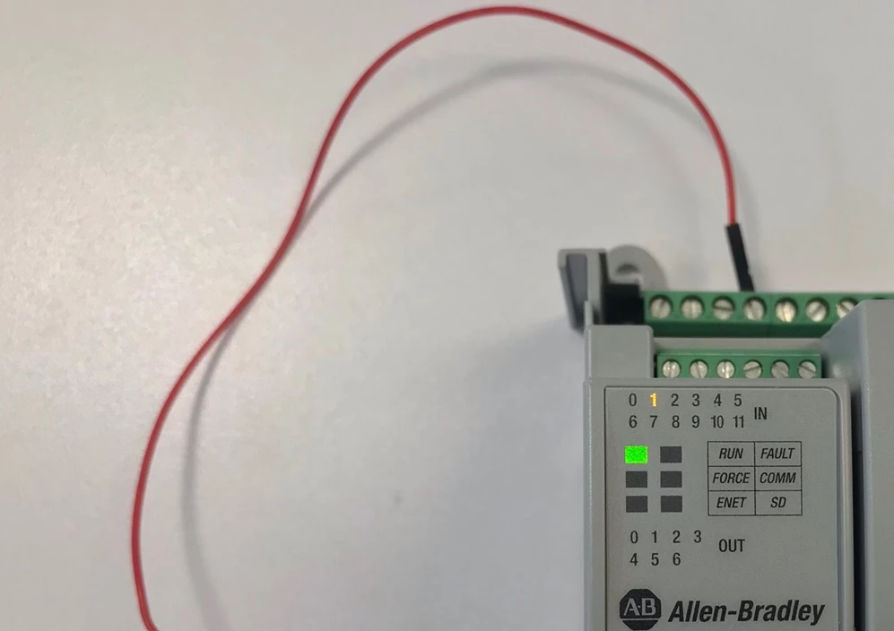

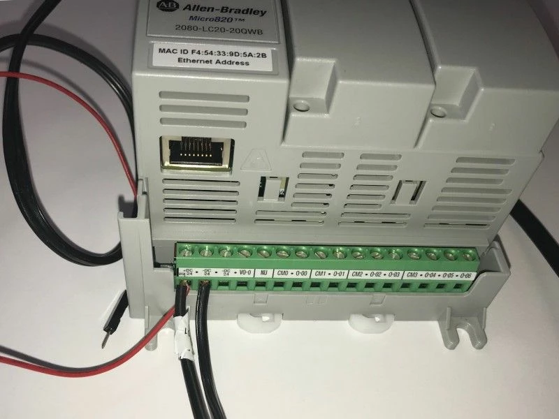

1. Connect the postive lead of a 24V power supply along with a 6" test lead to Terminal 1 of the output terminal block.
2. Connect the negative lead of the power supply to Terminal 2.

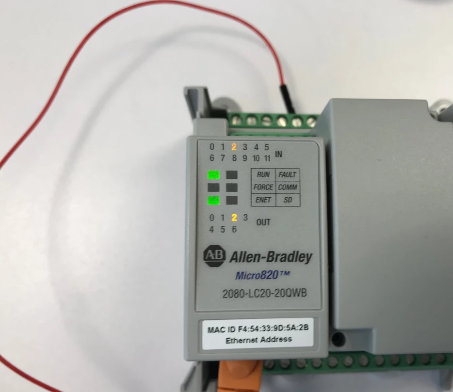

3. Confirm the test lead is secure from making contact with anything conductive; it will be  connected to +24V. Power on the supply and confirm the LEDs briefly light.
4. Carefully touch the test lead to the Input 1 terminal and confirm the indicator LED for Input 1 turns on.
5. Power off the supply before continuing to the next step.

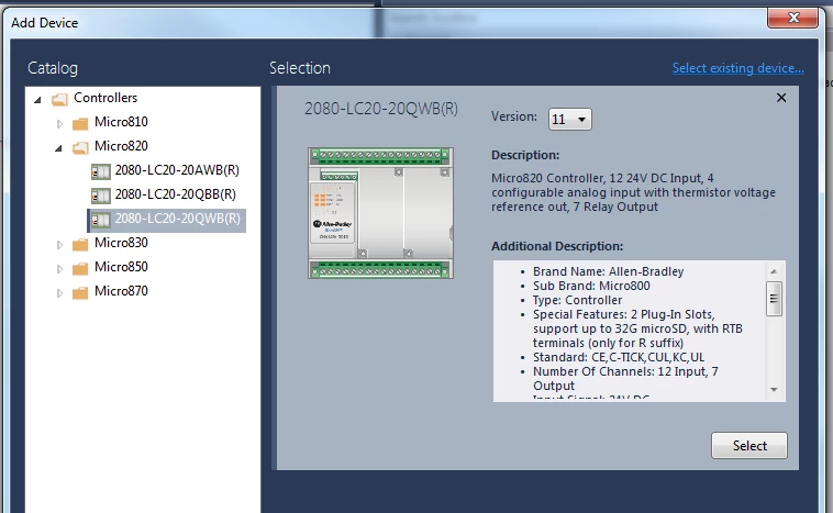

 1. After opening Connected Components Workbench, click New... in the Project section.
2. Enter ThingWorxGuide in the Name field and click Create.
3. Browse to the PLC model you are using and click Select, then Add to Project.

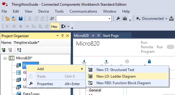

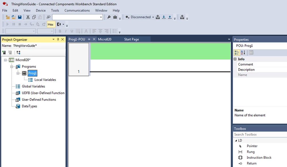

4. Right-click Program, then left-click Add > New LD: Ladder Diagram
5. Double-click Prog1 to open the ladder window.

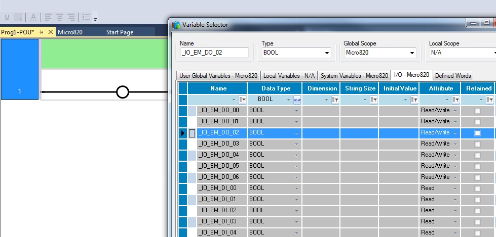

Ladder Logic

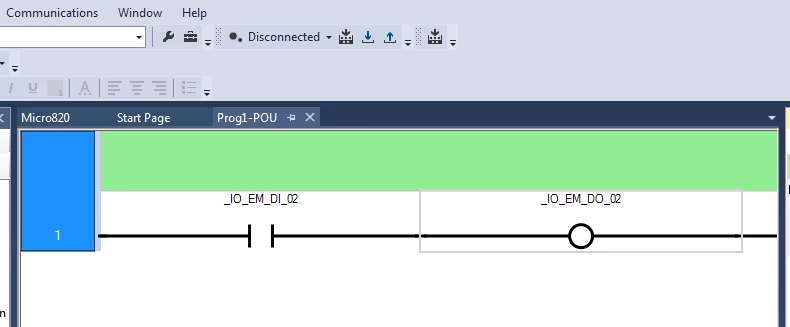

You will create a simple application that will turn on output 2 when there is a signal on input 2.

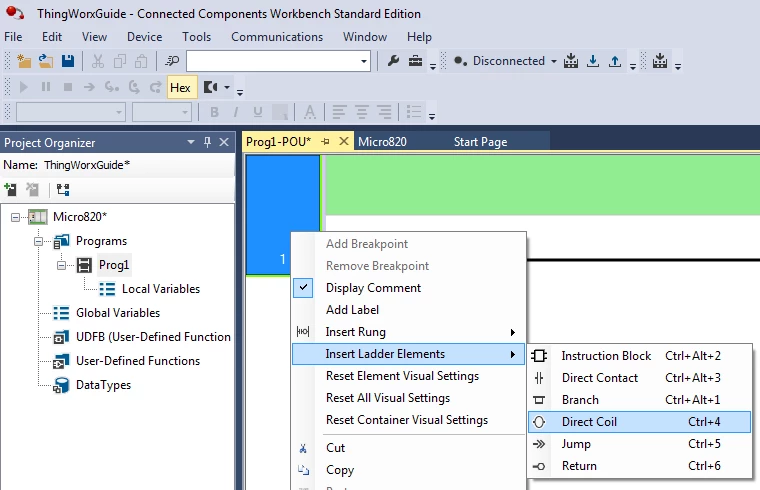

 1.. Right-click in the box to the left of the rung, hover over Insert Ladder Elements, then click on Direct Coil

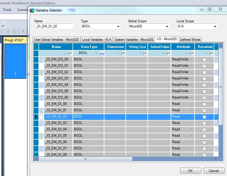

2. Click the I/O - Micro820 tab towards the right and select an output coil - this guide uses _IO_EM_DO_02. Then click OK
3. Add an input contact by right-clicking in the box to the left of the rung, hover over Insert Ladder Elements, then click on Direct Contact.
4. Click the I/O - Micro820 tab and scroll down to select an input - this guide uses _IO_EM_DI_02. Then click OK.
 5. The program window should now look like this:

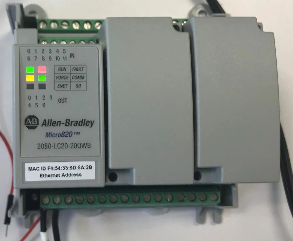

1. Secure the test lead then apply power to the PLC.
2. Connect an ethernet cable directly between the PLC and your Windows computer.

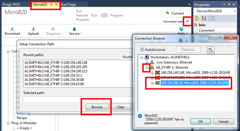

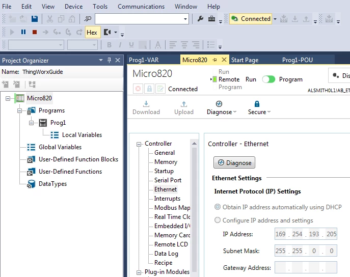

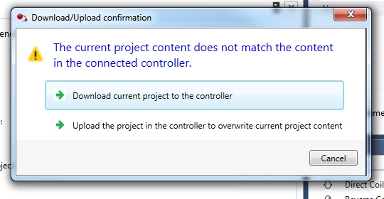

3. Click Device > Connect to connect to the PLC; a pop-up will appear saying the project does not match the program in the controller.
NOTE: When either your PLC or computer are restarted, they may be assigned a new IP address, requiring you to reconfigure the connection. Click the tab labled with your PLC, then click the pencil icon next to connection path, click Browse, expand the Ethernet driver, highlight the active controller, and click OK. Click Close and then Connect.

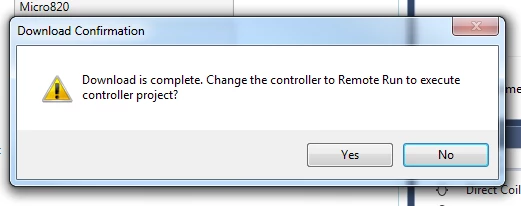

4. Click Download current project to the controller
5. Confirm overwriting any program in the controller by clicking Download.
6. After your project is downloaded, run it on the controller by clicking Yes.
7. Touch the test lead to the I-02 terminal, and your program will turn on the #2 output.
  • You can confirm your project is working by both hearing the soft click from the PLC and seeing the output indicator turn on.

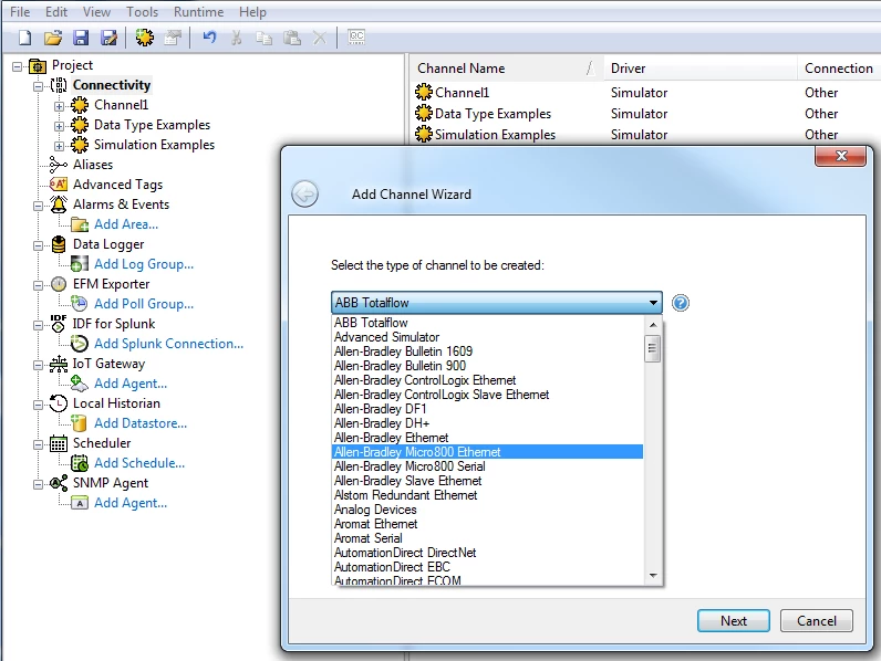

1. Open ThingWorx Kepware Server, right-click on Connectivity, and click New Channel.
2. Select Allen-Bradley Micro800 Ethernet from the drop-down, then click Next.
3. Click Next to accept the defaults, and click Finish to create Channel2.

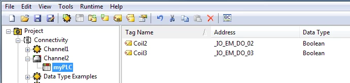

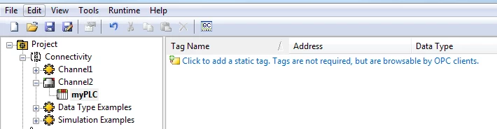

4. Click Click to add a device below Channel2, enter myPLC in the name field, and click Next.
5. Enter the IP address of your PLC, then click Next.
  • The IP address of your PLC is shown in Connected Components Workbench in Device > Configure.
NOTE: The IP address of the PLC may change when it is power cycled and must be updated in ThingWorx Kepware Server to match
6. Click Next to accept default values for each pop-up, and click Finish to create the myPLC device.

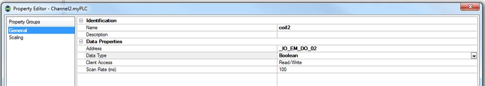

7. Click the Click to add a static tag message.
8. Enter Coil2 in the Name field, _IO_EM_DO_02 in the Address field, change the Data Type drop-down to Boolean, and click OK.
  •  The address must exactly match a variable name in the PLC.
9. Create a second tag by right-clicking on myPLC again and clicking New Tag.
10. Enter Coil3 in the Name field, _IO_EM_DO_03 in the Address field, select Boolean from the Data Type drop-down, and click OK.

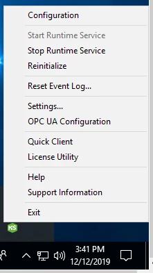

1. If the connection to the PLC stops working and there is a Thumbs Down icon next to your Properties, the ThingWorx Kepware Server trial edition drivers are not connected to your PLC.
  • The trial edition stops running after 2 hours and must be stopped and restarted.
  • Right-click on ThingWorx icon in system tray.
  • Click Stop Runtime service.
  • Wait a minute for the process to stop, then click Start Runtime service.
