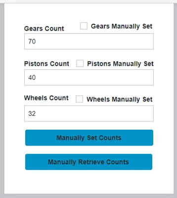

Execute the following steps to test that your application works as expected.
  1. Click the View Mashup button at the top.
    • You may have to disable your pop-up blocker to load the Mashup in a new browser tab.
2. Wait and observe the Mashup for at least 20 seconds, clicking the Manually Retrieve Counts button regularly.
NOTE: The values in the Mashup will increase roughly every 10 seconds, after you press the button to manually retrieve them. This happens because the Thing you imported earlier is simulating data and the work already done by the Edge and Backend Developers in this scenario. In this simulation, different production lines are continually producing new inventory, and that information is being fed into ThingWorx Foundation. As the count for each production line reaches 100, the batch is shipped out, and the count resets to 0 for the next iteration.
3. Check the Gears Manually Set Checkbox, change the Gears Count Text Field to read 7, and click the Manually Set Counts button. After 10+ seconds have passed, click the Manually Retrieve Counts button again.
NOTE: This simulates a situation where an IoT sensors in the inventory warehouse has failed. Maybe it's over or under-counting inventory. Maybe there's a network issue. Maybe the sensor has simply stopped working entirely. Regardless, the warehouse floor has contacted a user of your GUI, and asked them to manually set the inventory to the correct amount. Performing Step 4 is all that is required to do so. As long as the Gears Manually Set checkbox is active, the inventory does not increase on the 10 second timer. This is to prevent a malfunctioning sensor from providing incorrect data to your GUI.
4. Uncheck the Gears Manually Set Checkbox and click Manually Set Counts.
NOTE: The Gears Count starts increasing again after 10 seconds have passed. Remember to click the Manually Retrieve Counts button to see this change. This represents the previously-malfunctioning IoT sensor having been repaired.

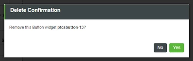

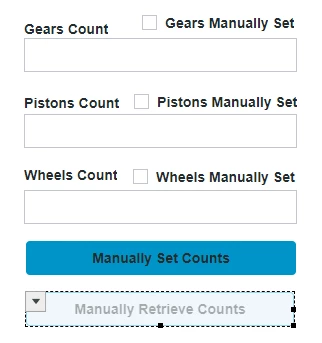

  1. Close your MVP Mashup browser-tab and return to the Mashup Builder.
  2. Click the button-manual-retrieve Widget to select it.
  3. Hit your keyboard's Delete key.
  4. Click Yes in the Remove the selected widgets? pop-up window.

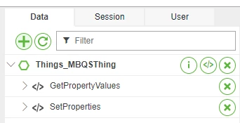

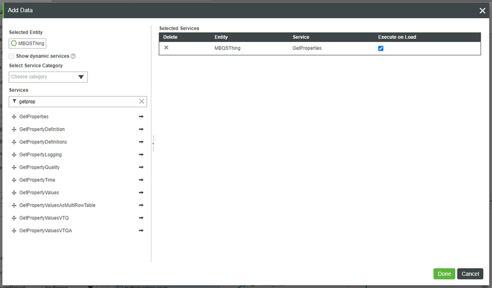

  5. Click the green </> button beside Things_MBQSThing in the top-right Data tab.
6. In the Services Filter field, type getprop.
7. Click the right-arrow beside GetProperties. Be sure to select GetProperties, not GetPropertyValues.

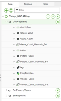

8. Check the Execute on Load checkbox.
9. Click Done.

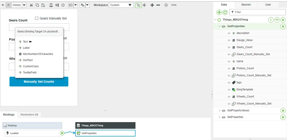

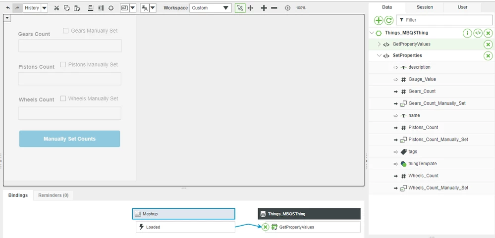

10. In the Data tab on the top-right, expand the newly-added GetProperties Service.

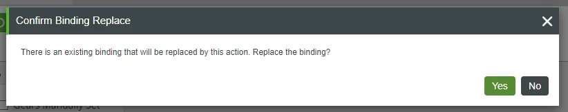

11. Drag-and-drop Gears_Count onto textbox-gears-count.
12. On the Select Binding Target popup, click Text.
13. On the Confirm Binding Replace pop-up, click Yes.
14. Repeat steps 11-13 for Pistons_Count and Wheels_Count onto their respective TextBox Widgets.
15. Drag-and-drop Gears_Count_Manually_Set onto checkbox-gears-manual.
16. On the Select Binding Target popup, click State.
17. On the Confirm Binding Replace pop-up, click Yes.
18. Repeat steps 15-17 for Pistons_Count_Manually_Set and Wheels_Count_Manually_Set onto their respective Checkboxes.

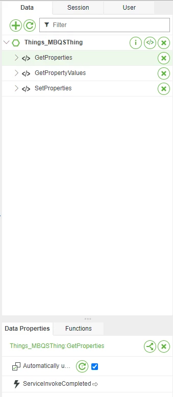

19. Click the GetProperties Service to select it.
20. In the bottom-right Data Properties section, check the Automatically update values when able box.
21. Click Save.

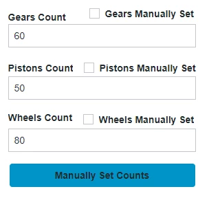

22. Click View Mashup.
You have now enhanced your MVP Mashup based on user feedback. The Counts in each TextBox will automatically update whenever there is a change in the Property values, as requested.
