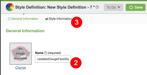

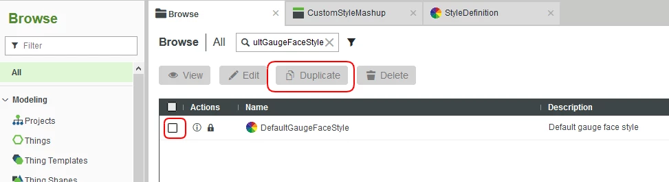

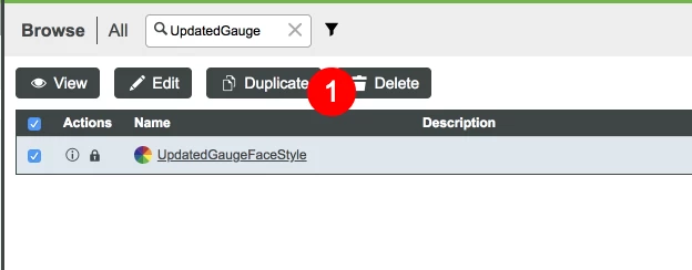

  1. Filter and click the checkbox next to the DefaultGaugeFaceStyle Style Definition.
  2. Click Duplicate.

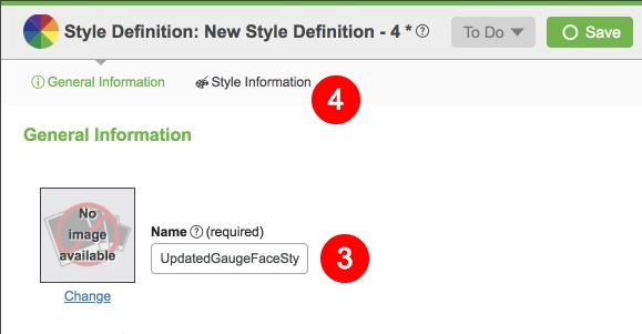

  3. Name the Style Definition UpdatedGaugeFaceStyle.
  4. Click Style Information.

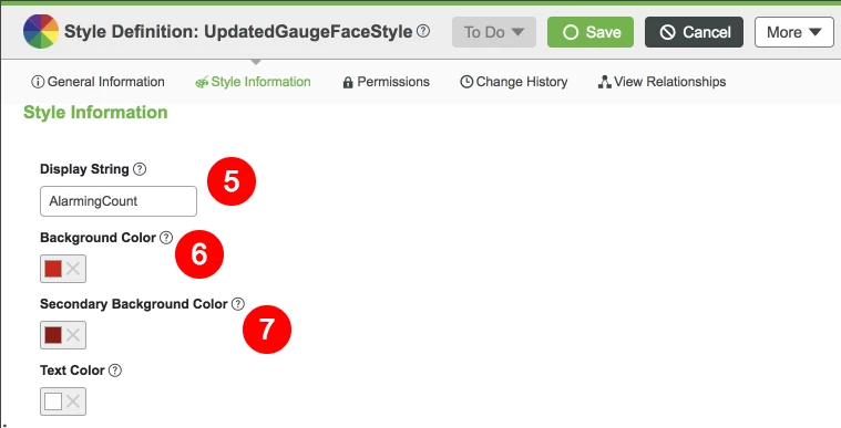

  5. Set the Display String property as AlarmingCount.
  6. Change the Background Color to light red (color code #D60000 is used in this example).
  7. Change the Secondary Background Color to a darker red (color code #960A0A is used in this example).

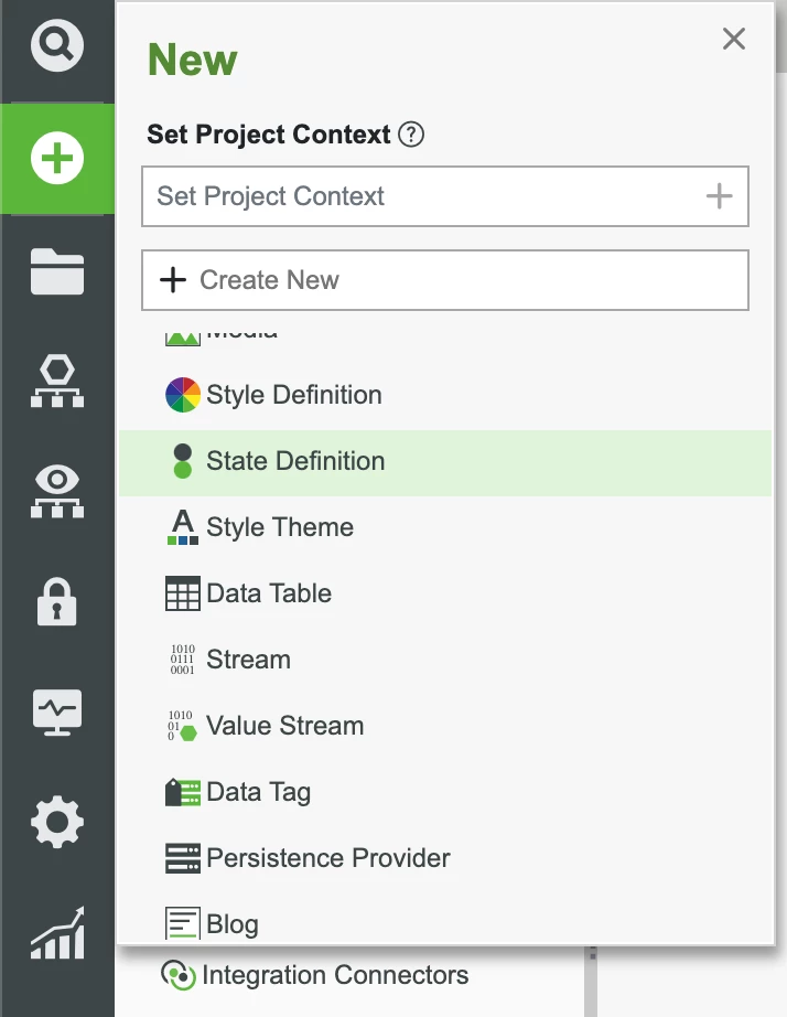

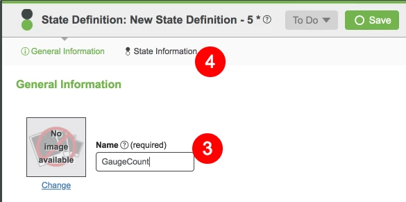

  1. In the ThingWorx Composer, click the + New at the top of the screen.
  2. Select State Definitions in the dropdown.
  3. Set the Project (ie, PTCDefaultProject).
  4. Name the State Definition GaugeCount.

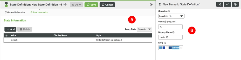

  5. Click States Information.
  6. Set the Apply States dropdown to Numeric.
  7. Set the following values for the default state:
Property Value
OperatorLess than (<)
Value10
Display NameUnder 10
StyleDefaultGaugeFaceStyle

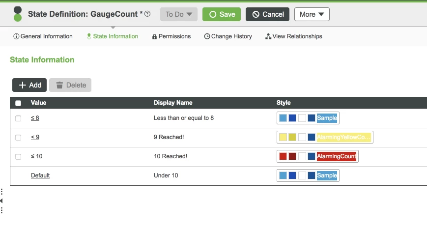

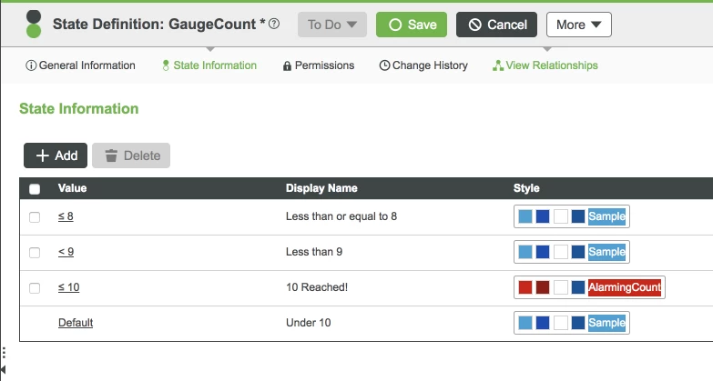

8. Click the Add State button to create the other states to match the below image:
9. Click Save.
You’ve now created a State Definition. If the value is below 10, the default Gauge format will be applied. Once the value reaches 10, notice the state-based changes you defined are displayed in the appearance of the Gauge.

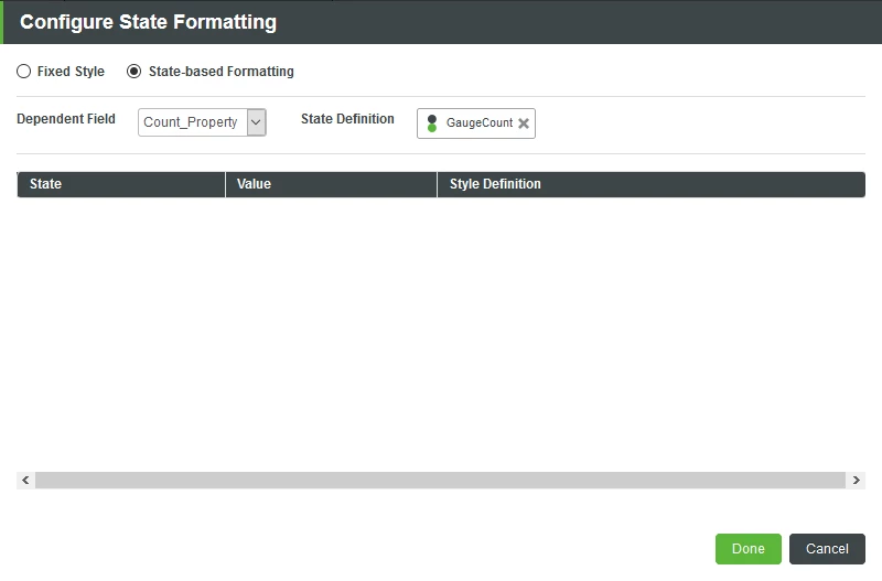

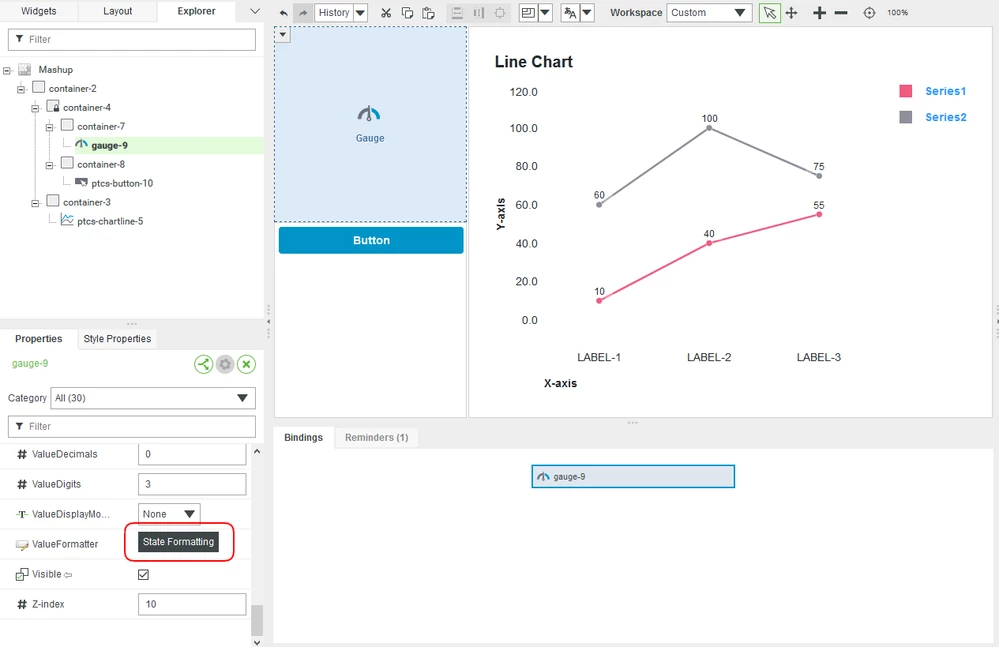

  1. Select the Gauge Widget in the Workspace pane and click the ValueFormatter property.
  2. Select the State-based Formatting radio button.
  3. Choose Count_Property for the Dependent Field drop-down and select the GaugeCount State Definition that we just created.
  4. Click Done and Save the Mashup.

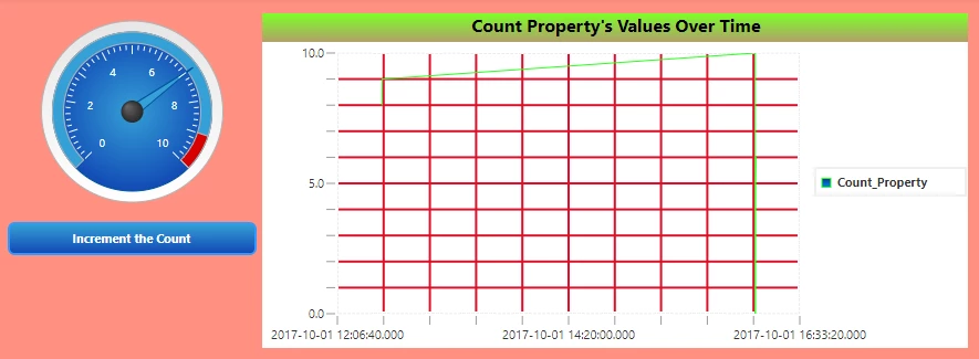

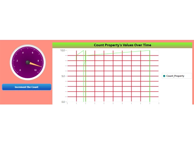

  5. Click View Mashup. If you used the color schemes mentioned, your new HelloWorldPlayground Mashup should look like this.
  6. Click the Increment the Count button to see the state changes.
The Gauge now displays a visual indication for when the count is approaching 10.

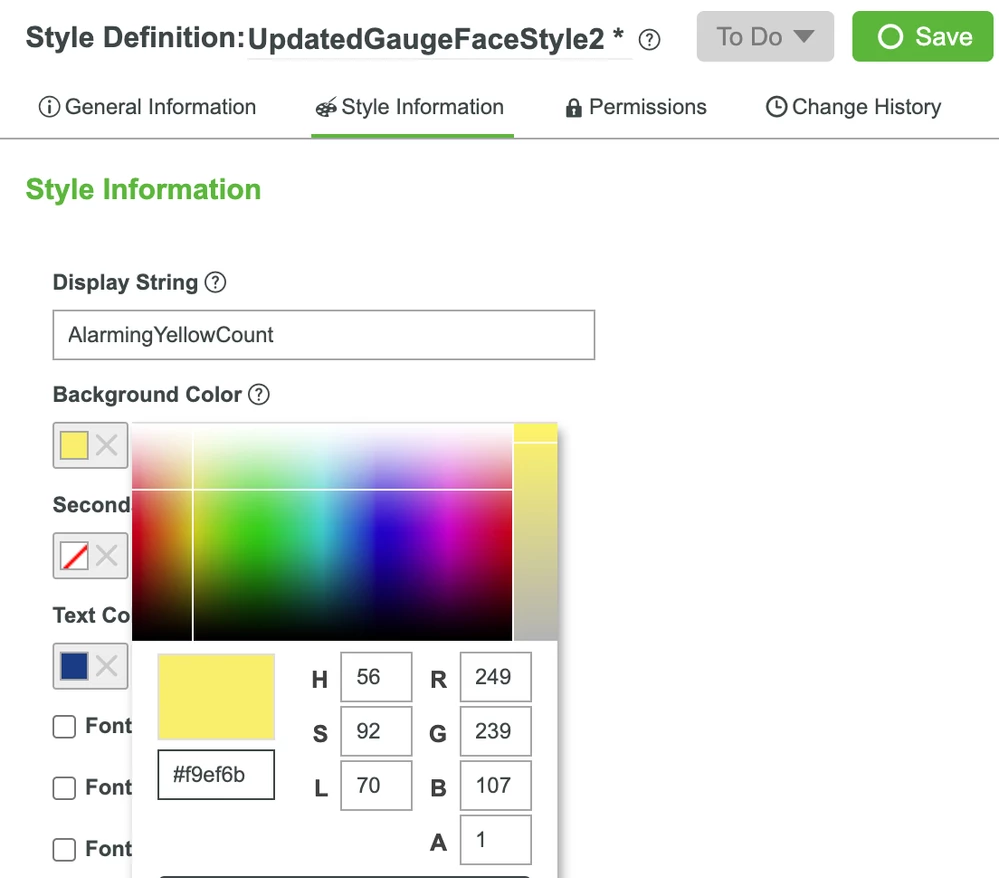

To further enhance the user experience, you could add another color that warns the user in advance before the threshold is reached. For this example, we will update our State Definition and create a Style Definition that uses the color yellow.
  1. Duplicate the UpdatedGaugeFaceStyle Style Definition.
  2. Name the Style Definition UpdatedGaugeFaceStyle2.
  3. Click Style Information.
  4. Set the Display String property to AlarmingYellowCount.
  5. Set the Background Color property to yellow (color code #F9EF6B is used in this example).
  6. Set the Secondary Background Color property to a darker yellow (color code #D2CD0E is used in this example).
  7. Open the States Information tab of the GaugeCount State Definition.
  8. Update the State Definition to fit the image below and utilize the Style Definition we just created:
  9. Click Save and View Mashup to see the updated runtime appearance of the application.

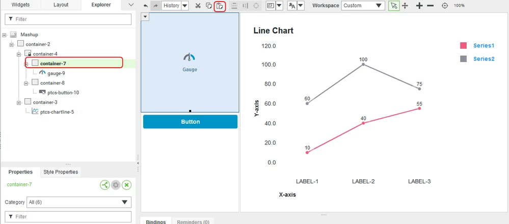

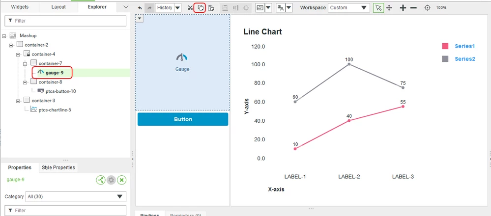

  1. Select the Gauge Widget in the Workspace pane.
  2. Click the Copy button in the toolbar.
  3. Select the Container in the Workspace pane.
  4. Click the Paste button in the toolbar. If you Gauge Widgets will not go on top of one another, set the Z-index value of the new Gauge to a smaller number and set the Container Layout Position to static.
  5. Click the green Add Service button in the Data tab next to Things_Hello_World_Thing1 to add two services from you Things_Hello_World_Thing1 Entity.

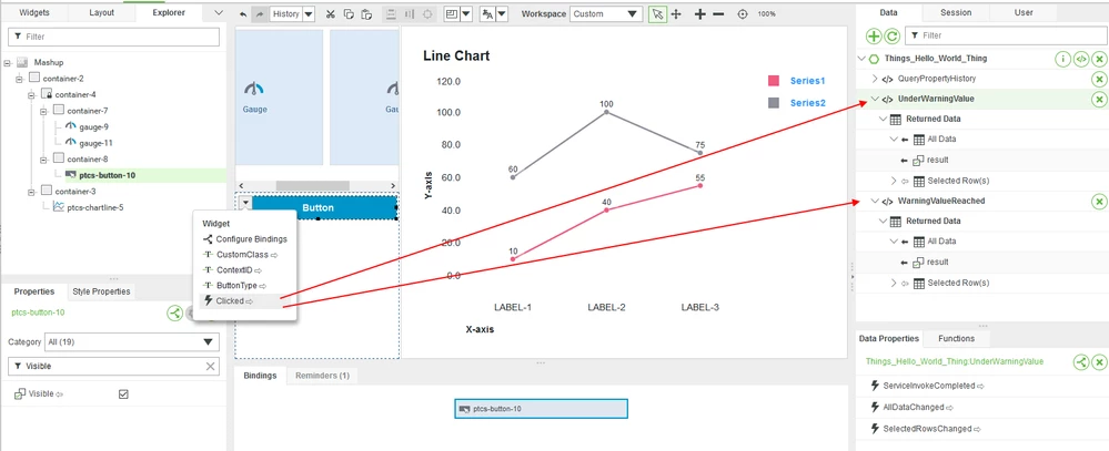

Binding Data and Event

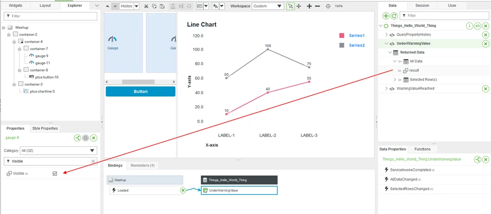

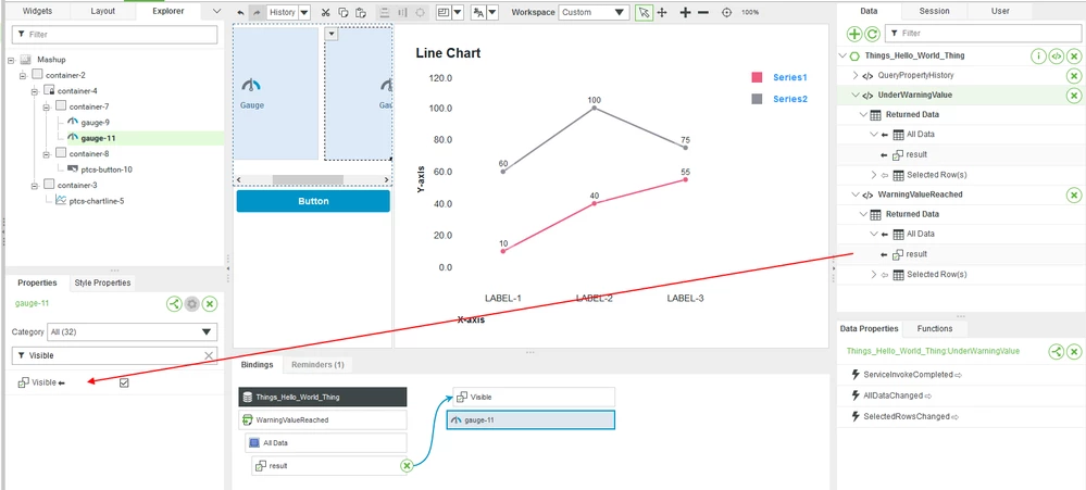

  1. With the original Gauge selected, scroll to the Visible property value.
  2. Drag and drop the UnderWarningValue service result to the Visible property.
  3. With the new Gauge selected, scroll to the Visible property value.
  4. Drag and drop the WarningValueReached service result to the Visible property.
  5. Select the Button Widget in the Workspace pane.
  6. Drag and drop the Clicked Event to the UnderWarningValue and WarningValueReached services.
This will ensure the other Services are run whenever the Increment the Count button is clicked.
The UnderWarningValue service will return true if the Count property is under 9. The WarningValueReached service will return true if the Count property is equal to or above 9. The result sent to the original Gauge controls whether the Gauge is visible to users or not.

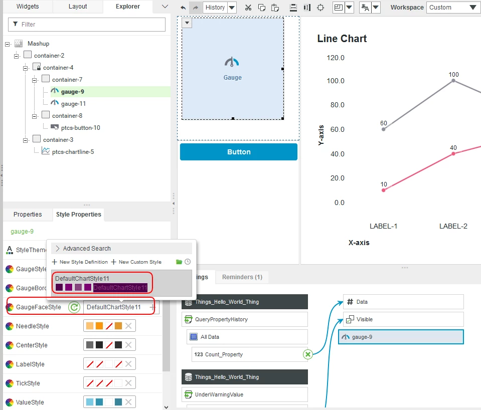

7. Select the new Gauge in the Mashup or Explorer pane.
8. Clear the GaugeFaceStyle Style Definition and replace it with the DefaultChartStyle11.

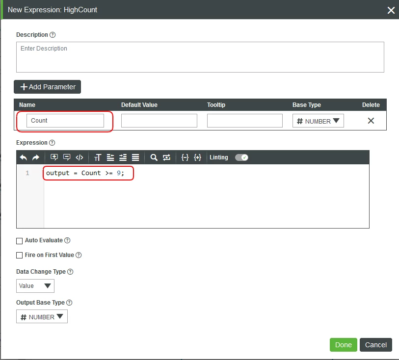

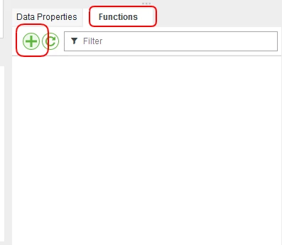

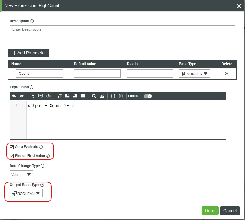

  1. In the Functions Tab in the bottom right. Add a new function.
  2. Set the Function Type to Expression and name it HighCount.
  3. Click Next
  4. Click Add Parameter and add a Count (Number) parameter.
  5. Set the Expression property to output = Count >= 9;.
  6. Check the Auto Evaluate and Fire on First Value checkboxes.
  7. Click Done.

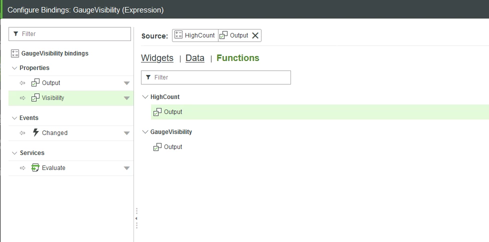

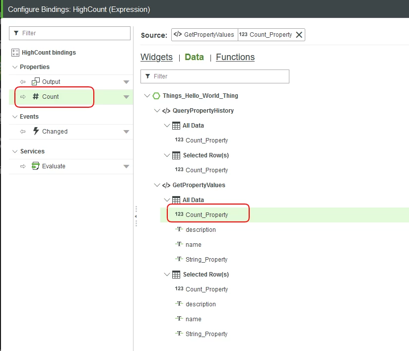

Bind and Evaluate Event

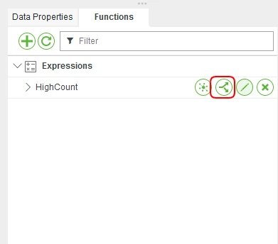

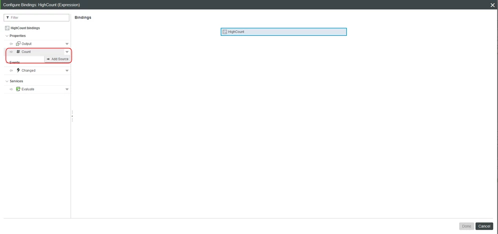

  1. In the Functions Tab in the bottom right, click the bind button of our new Function.
  2. Click the dropdown by the Count input parameter. Click Add Source.
  3. Select Data, then the Count_Property from the GetPropertyValues service.
  4. Redo the past steps for a second Function. Name this function GaugeVisibility with a parameter of type Boolean with the name Visibility.
  5. Update the second Expression Widget’s Expression property to output = Visibility != true;.
  6. Ensure the checkboxes are checked and bind to the output of our last Function.
  7. Connect the output of this Function to the second Gauge.
