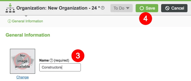

Create Organization
Follow the steps below to create an Organization and make it login ready. Once your Organization is saved, you are provided with a login screen. Customize the login page to your liking with the General Information tab of the Organization after creating it.
  1. In the ThingWorx Composer, click the + New at the top of the screen.
  2. Select Organization in the dropdown.
  3. Name your Organization Constructors.
  4. Set the Project field (ie, PTCDefaultProject) and click Save
  5. Click Edit and select the Organization tab to see the hierarchy.
  6. With the top organization selected, in the Members search bar, search for the user you have created yourself and add them. Keep track of the user you added, they will be needed to log into the application later in this guide.

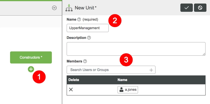

Create Organizational Units
Let's create the structors for our Organization. With the Constructors Organization open, follow the directions below:
  1. Click the green + button under the structure you would like to expand.
  2. Name your Organization unit UpperManagement
  3. In the Members search bar, search for the user or user group you created and add it.
  4. Click Save.
Repeat the steps to create the full hierarchy of the organization and its members.

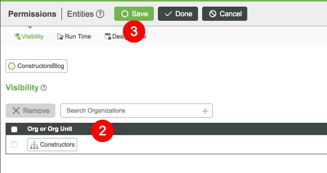

Setup Entity Visibility
Visibility is a simple form of access control. If an entity is visible to members of an organizational unit, then its members have access to the entity.
  1. Select the Permissions tab of any Thing you created in Composer.
  2. Filter and select Constructors in the Search Organizations field.
  3. Click Save.

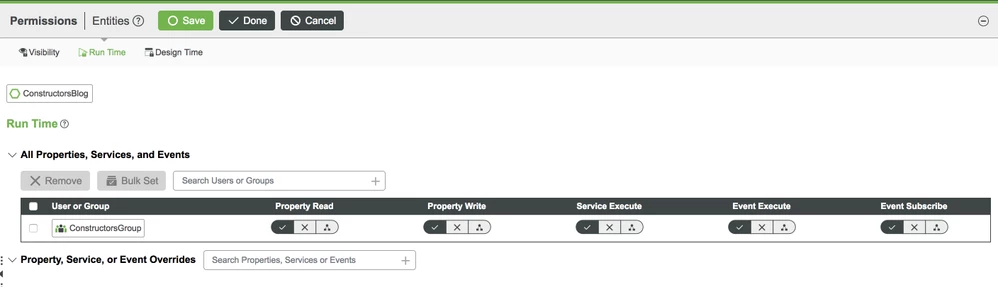

Step 3: Security and Permissions
By Default, new Users have no permission configurations. Permissions can be defined for any Entity created on the ThingWorx platform. All Entities have permission control for both design time and run time.
Design time is the period in which changes can be made to the Entity in Composer. Run time is the period in which the application is running and calls are made.
Permissions should be set for each and every Entity within the application in order to keep it secure and maintain access to services.
  1. Select the Permissions tab of any Thing you created in Composer (ie, ConstructorsBlog).
  2. Select the Design Time or Run Time tab.
  3. After selecting one, filter and select a User or UserGroup to set their permissions.
  4. Set the Allow, Deny or Inheritence markers to set permissions respectively.
The Inherit category allows a user to inherit permissions from the user group it belongs to.

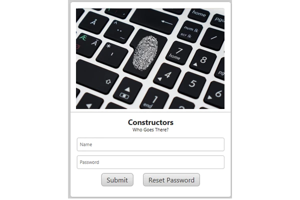

If you plan to use a Login Screen, use the View Mashup URL generated from the Login Mashup you create. To view the login page of your application, type the following URL: [server]/Thingworx/FormLogin/ (ie, localhost/Thingworx/FormLogin/Constructors).
The login page for the sample application can be found at: [server]/Thingworx/FormLogin/Constructors.
To log in using this screen, type in the username and password of a user that is in the organization.

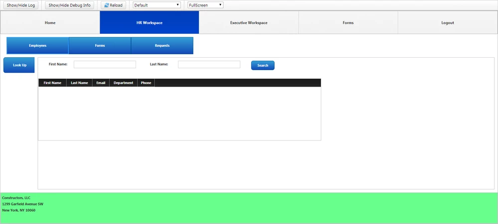

To use one of the example Users, set their password in the Composer and test it within the login prompt. Based on the permissions you set, users will have a different view of the application when they log in.
