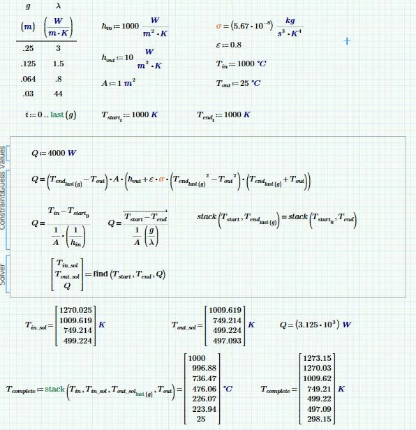

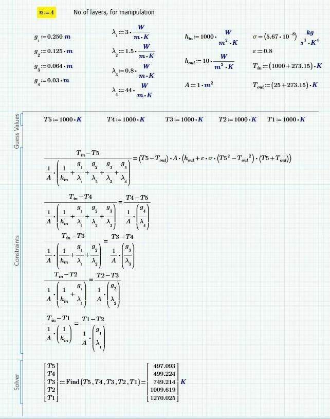

I'm looking a way of automatic solution of HT problem with multilayer steady heat transfer with numbers of layer dependency.
I'd like to put n variable as number of materials layer then put thicknes and thermal conductivity as a consequences of layer namber and finally get a solution for n=2,3...k layers.
Thank you in advance for any idea
I enclose MP 4.0 file.

I think the link did that, although yours is complicated by having different equations at the start and end.  But the concept is the same.  Since I can probably use something similar someday, I took a stab at it.  Seems to work - you can add or delete rows to the table. But user beware, etc.
T_start is the temp at the start of a 'plate', and T_end is the temp at the end of a plate.

May by this Mathcad-Websheet is any help for you
http://twt.mpei.ac.ru/MCS/Worksheets/Thermal/T-T-2-Chapter-3-3-3-1.xmcd

The problem is that I have to solve the non-linear equation due convecting and radiation therms which are set as outflow boundary condition.
This is a first step to get interlayer and inflow temperatures.

I think this is similar to a problem I posted here (N orifices in series).
https://community.ptc.com/t5/PTC-Mathcad-Questions/Solve-block-for-N-inputs/m-p/484610#M173308
See MJG's solution - the trick is in the 'stack'ing of the pressures.
