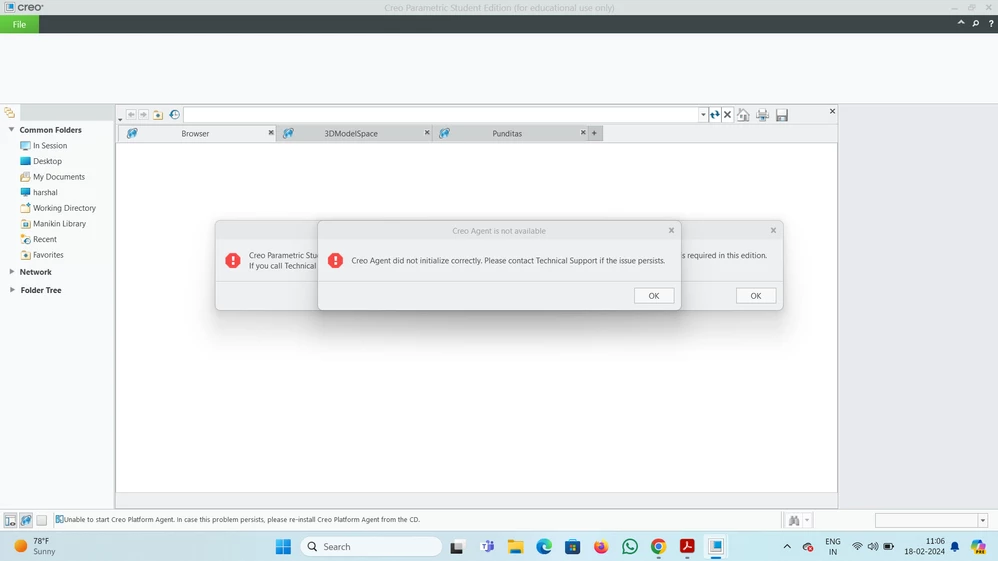

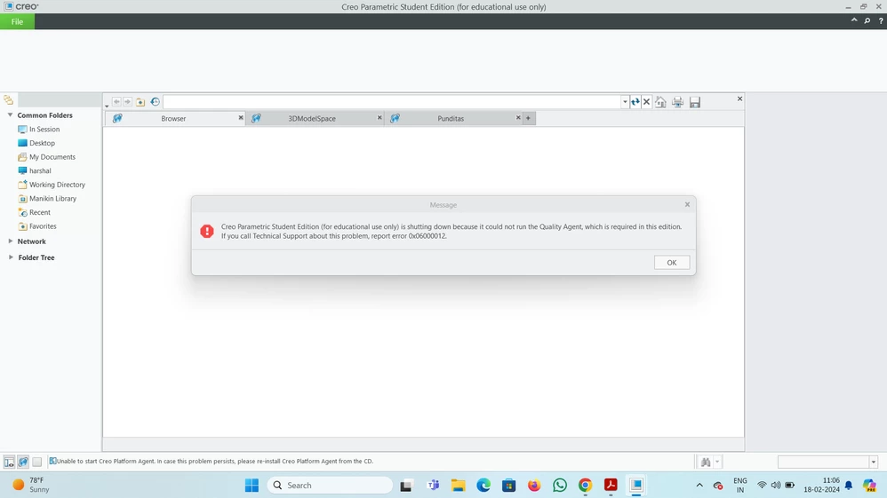

RESPECTED SIR,

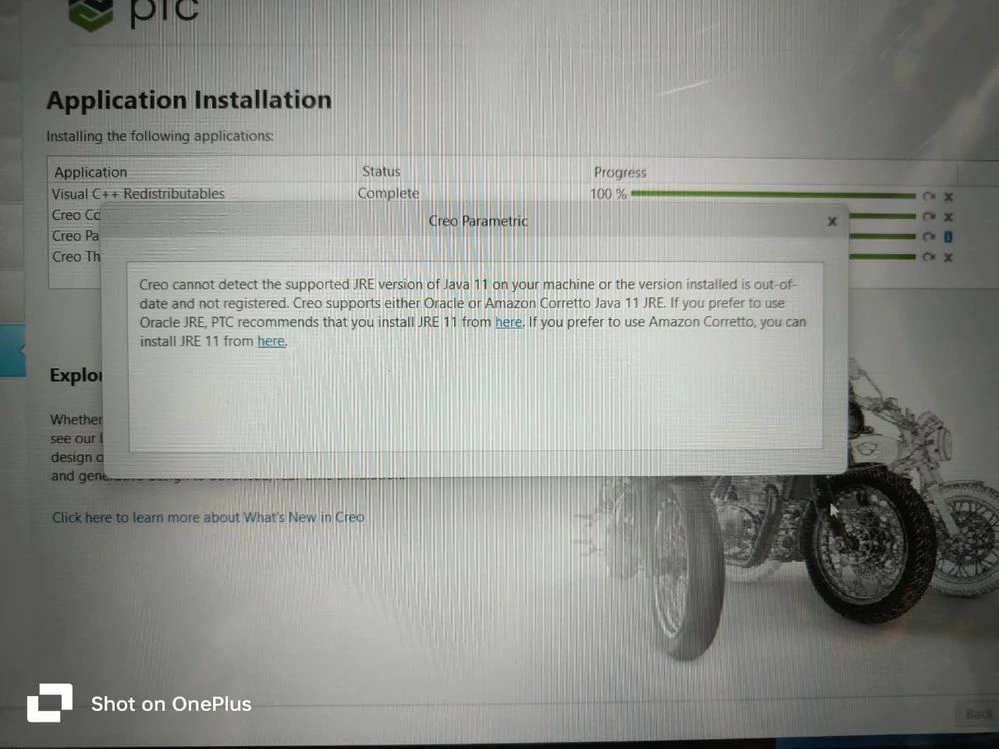

I am the user of student version of CREO 10.00. I installed the software the error is occurs that software not detecting some technical data. There is attachment. Please solve this problem as early as possible. Screenshot 2024-02-18 110611.pngScreenshot 2024-02-18 110651.pngWhatsApp Image 2024-02-17 at 17.02.03_2672dca2.jpg
But when I installed student version CREO 9.00 that time this problem had not occured. In same laptop I had installed it. So please as early as possible please solve this problem. OR give another solution.

Check whether "C:\Program Files\PTC\DiagnosticTools\x86e_win64\obj\qualityagent.exe" does exist.
If the file exists then:
  • Open C:\Program Files\PTC\Creo 10.0.0.0\Common Files\text\config.pro file in Notepad and add following line at the end of the file, save the file.
quality_agent_path  C:\Program Files\PTC\DiagnosticTools\x86e_win64\obj\qualityagent.exe
Note:
Read https://community.ptc.com/t5/System-Administration/Issues-Using-Creo-10-0-Student-Edition/m-p/929474 discussion.

Message related to Java is not important ... Creo will run even without Java.
