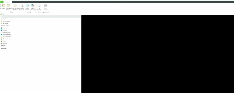

I am using Creo Parametric Release 11.0 and Datecode11.0.6.0
After installing PTC Creo (11.00.07), I attempted to open various files. However, only assembly (.asm) and part (.prt) files will open. When I view a part, the background is completely black.
Here are the errors that I faced
No error messages. but Despite successfully creating and saving new sketches, the part view still shows a black background. Changing appearance settings did not resolve the issue. I still could not visit the part

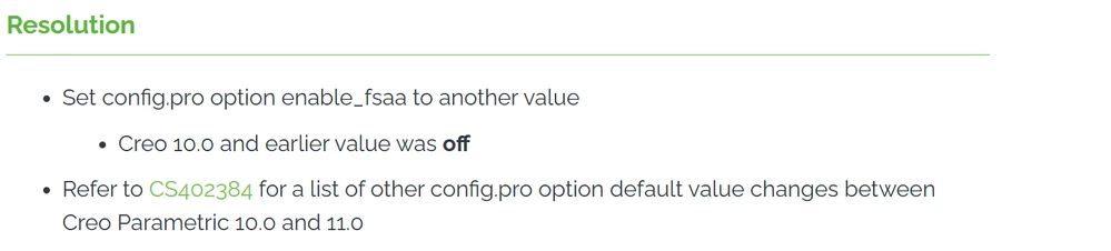

    The issue is solved after closing function (adding config: enable_fsaa, value:off).
    (PTC article: Article - CS417033, Graphics Window does not display any geometry or drawing in Creo Parametric 11)
