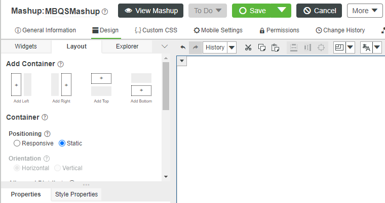

  1. Click Browse > VISUALIZATION > Mashups > + New.
  2. Keep the default of Responsive (with NO Responsive Templates chosen), and click OK in the pop-up window.

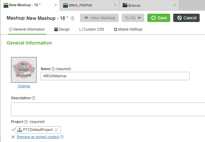

  3. In the Name field, enter MBQSMashup.
  4. If the Project field is not already set, search for and select PTCDefaultProject.
  5. At the top, click Save.
  6. At the top, click Design.
  7. On the left, click the Left Arrow to slide-back the navigation pane, leaving more room for the Mashup Builder.
  8. At the topleft on the Layout tab, for Positioning, check the radio-button for Static.

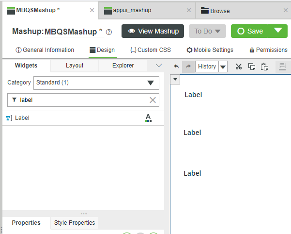

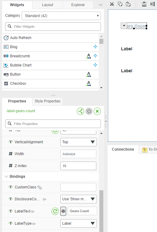

  1. Select the Widgets tab, then drag-and-drop three Label Widgets onto the central Canvas.

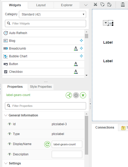

  2. With the top Label Widget selected (by clicking on it), change the DisplayName to label-gears-count and hit the Tab key on your keyboard to lock in the modification.

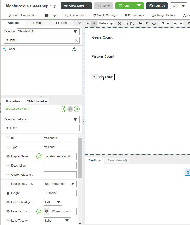

NOTE: You can find the DisplayName and all other Widget Properties in the bottom-left of the Mashup Builder. Changing the Widget DisplayNames to recognizable values is highly recommended, as it assists with your logic inspection in the bottom-center Connections window.
       3. With the newly-named label-gears-count still selected, type Gears Count in the LabelText field and hit the Tab key.
      4. Click on the middle Label; then, in the bottom-left Widget Properties panel, change the DisplayName to label-pistons-count and LabelText to Pistons Count.
      5. Similarly, change the bottom Label's DisplayName to label-wheels-count and LabelText to Wheels Count.
      6. Click Save.

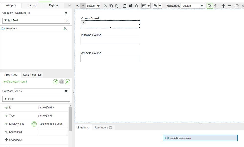

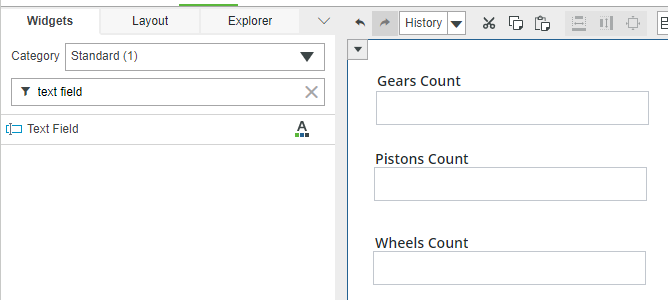

  1. Drag-and-drop three Text Field Widgets onto the central Canvas.
  2. With the top Text Field Widget selected, change the DisplayName to textfield-gears-count and hit the Tab key.
  3. Change the middle Text Field's DisplayName to textfield-pistons-count, and hit the Tab key.
  4. Change the bottom Text Field's DisplayName to textfield-wheels-count, and hit the Tab key.
  5. Click Save.

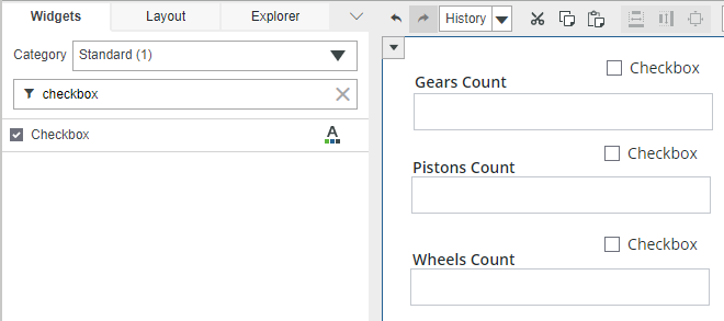

  1. Drag-and-drop three Checkbox Widgets onto the central Canvas.
  2. With the top Checkbox Widget selected, change the DisplayName to checkbox-gears-manual and the Label property to Gears Manually Set.
  3. Change the middle Checkbox's DisplayName to checkbox-pistons-manual and Label to Pistons Manually Set.
  4. Change the bottom Checkbox's DisplayName to checkbox-wheels-manual and Label to Wheels Manually Set.
  5. Click Save.

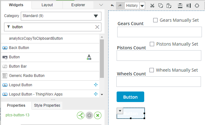

After our manual count has been entered, we need to trigger storing it in the backend. We can do this with a Button Widget. In addition, it would be helpful to be able to update the changing counts in the Textboxes without having to reload the entire Mashup. Follow the subsequent steps to add Buttons.

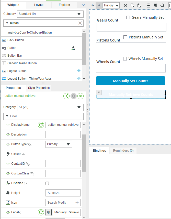

  1. Drag-and-drop two Button Widgets onto the central Canvas.
  2. With the top Button Widget selected, change the DisplayName to button-manual-set, the Label to Manually Set Counts, and click-and-drag the right-side of the Button to expand its size.
  3. With the bottom Button Widget selected, change the DisplayName to button-manual-retrieve, the Label to Manually Retrieve Counts, and click-and-drag the right-side of the Button to expand its size.
  4. Click Save.
