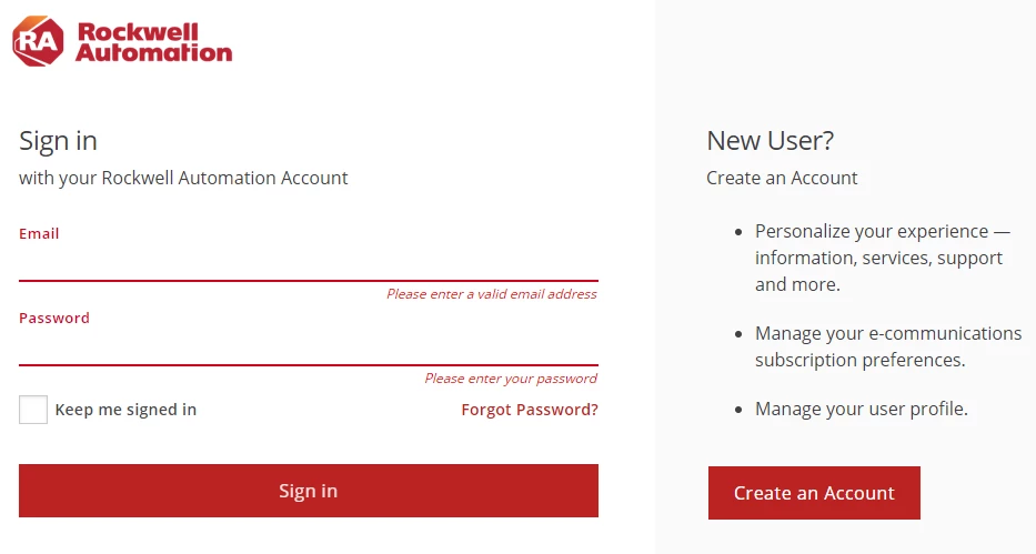

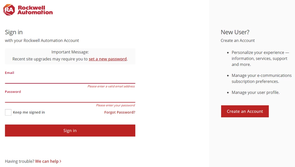

To access Rockwell Automation software, you first have to create an account on the Rockwell Automation website.
  1. Go to the Rockwell Automation site.
  2. In the top-right, click the "person symbol" for Account.
  3. On the right, click Create an Account.

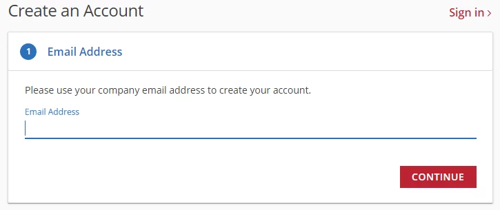

  4. Enter a valid email address which you control and click Continue.

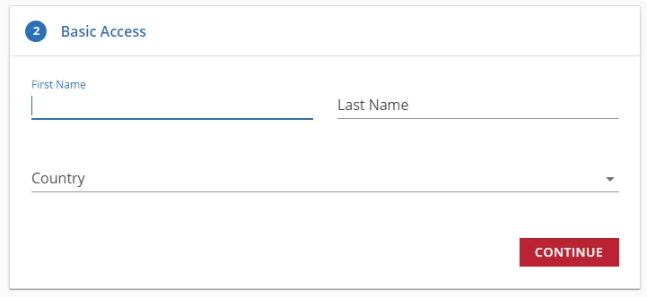

  5. Enter your first and last names, your country, and click Continue.

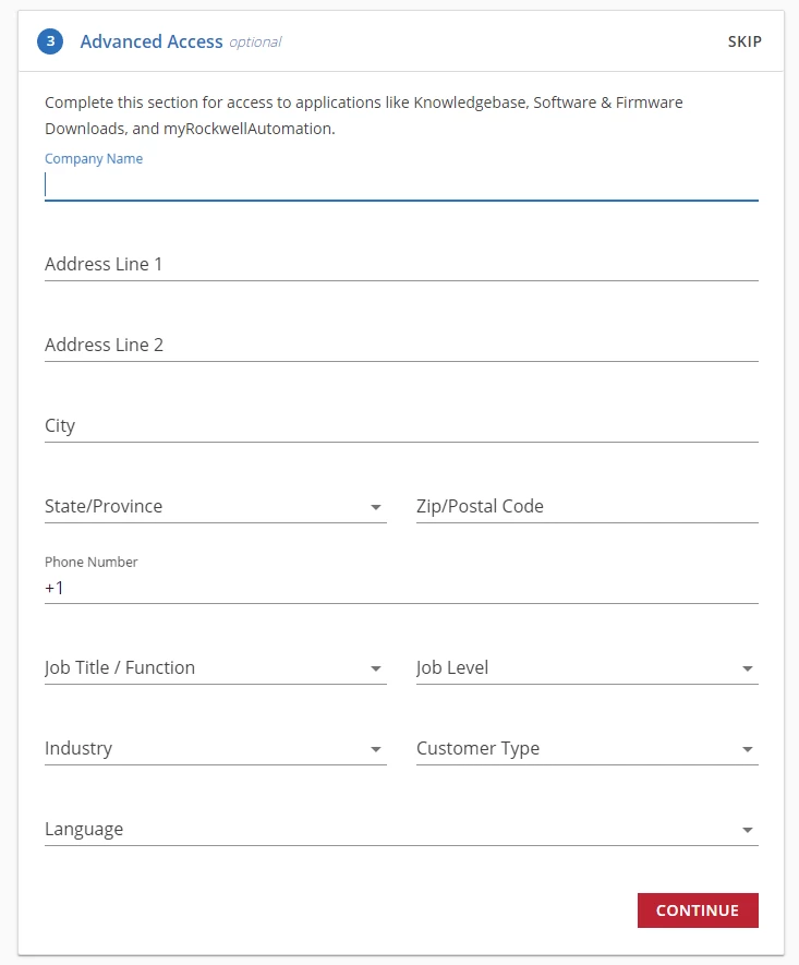

  6. Enter your job information and click Continue.

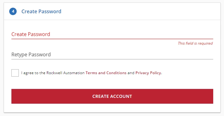

  7. Enter and re-enter a password, check the EULA agreement box, and click Create Account.

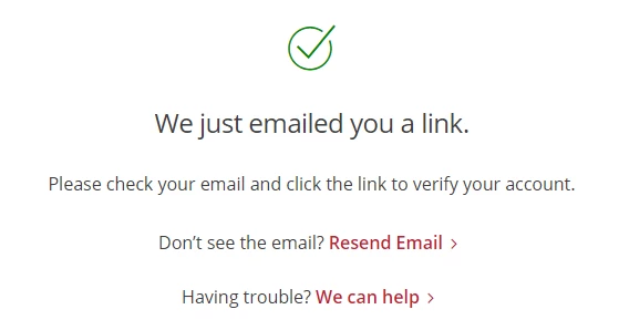

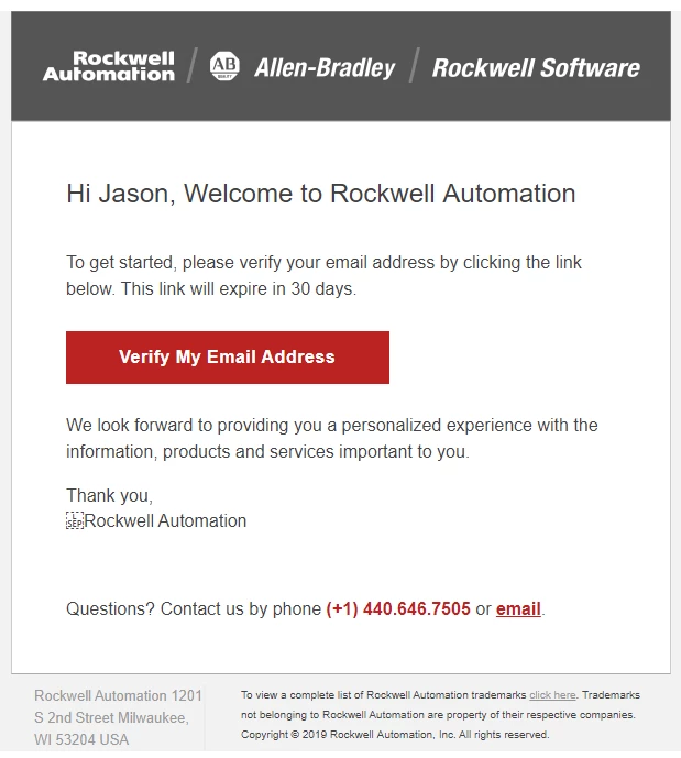

  8. Rockwell will send a verification email to the address you previously entered.

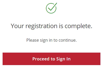

  9. Locate the email and click Verify My Email Address.
  10. A new browser tab will open with your verification; click Proceed to Sign In.
  11. Sign-in with your verified email address.

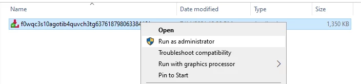

  7. Right-click on the download and select Run as administator.

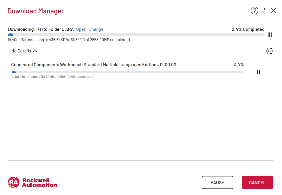

  8. The download-manager will then begin the download of the actual software.
    • Click Close when the download has completed.

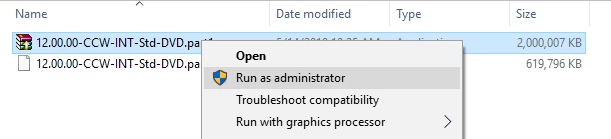

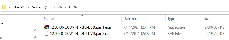

  9. Notice that there is now a new C:\RA\CCW folder.

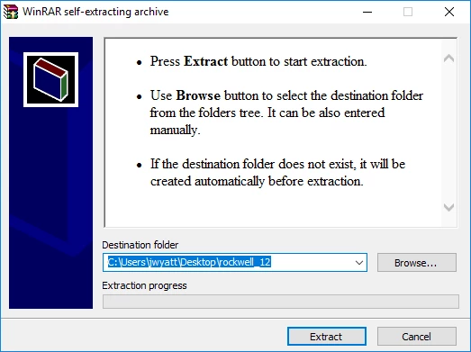

  10. Right-click on part1.exe and select Run as administator.

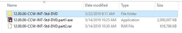

  11. On the WinRAR self-extracting archive window, click Extract.
  12. Notice that there is now a new "DVD" folder.

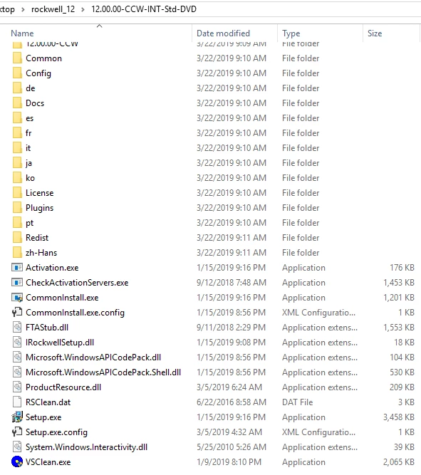

  13. Navigate into the "DVD" folder.
  14. Notice the Setup.exe file, which will be used to install Connected Components Workbench.

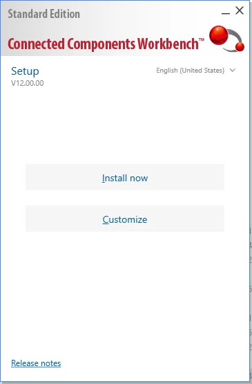

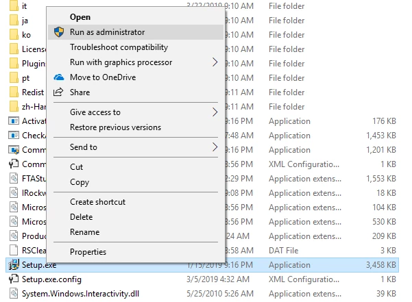

  1. Right-click on Setup.exe and select Run as administrator.
    • Click Yes to allow the program to make modifications to your computer.

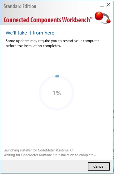

  2. Click Install now.

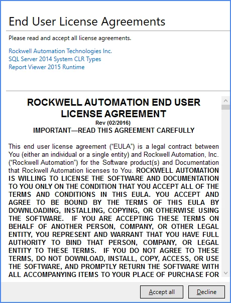

  3. On the EULA screen, click Accept all.
  4. Allow the installer to run to completion.
    • This may take ~30 minutes..

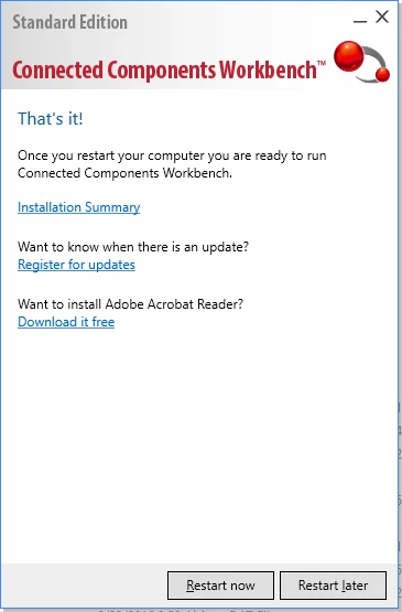

  5. Click Restart now to reboot and complete the installation.

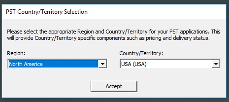

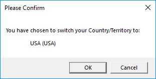

  6. After restarting, you may be asked to set your Country/Territory.
  7. Click OK to confirm.

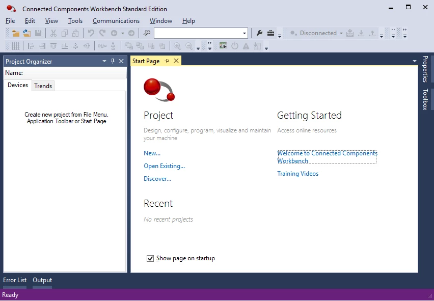

  9. Click Connected Components Workbench.
