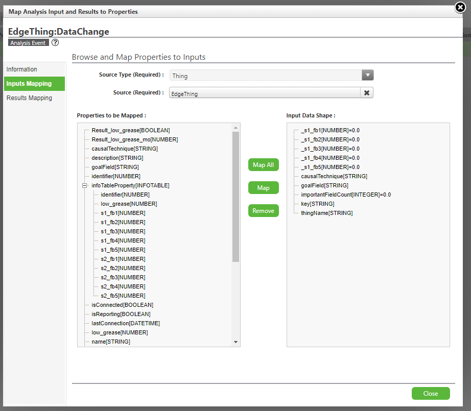

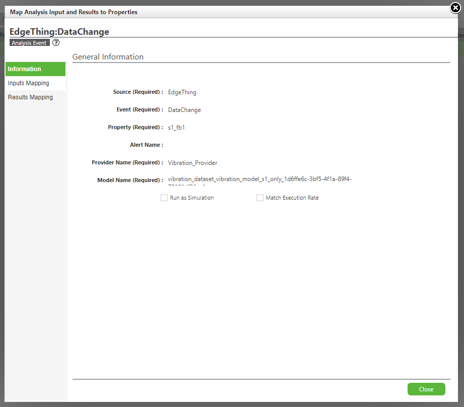

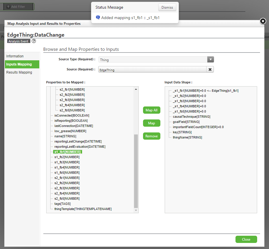

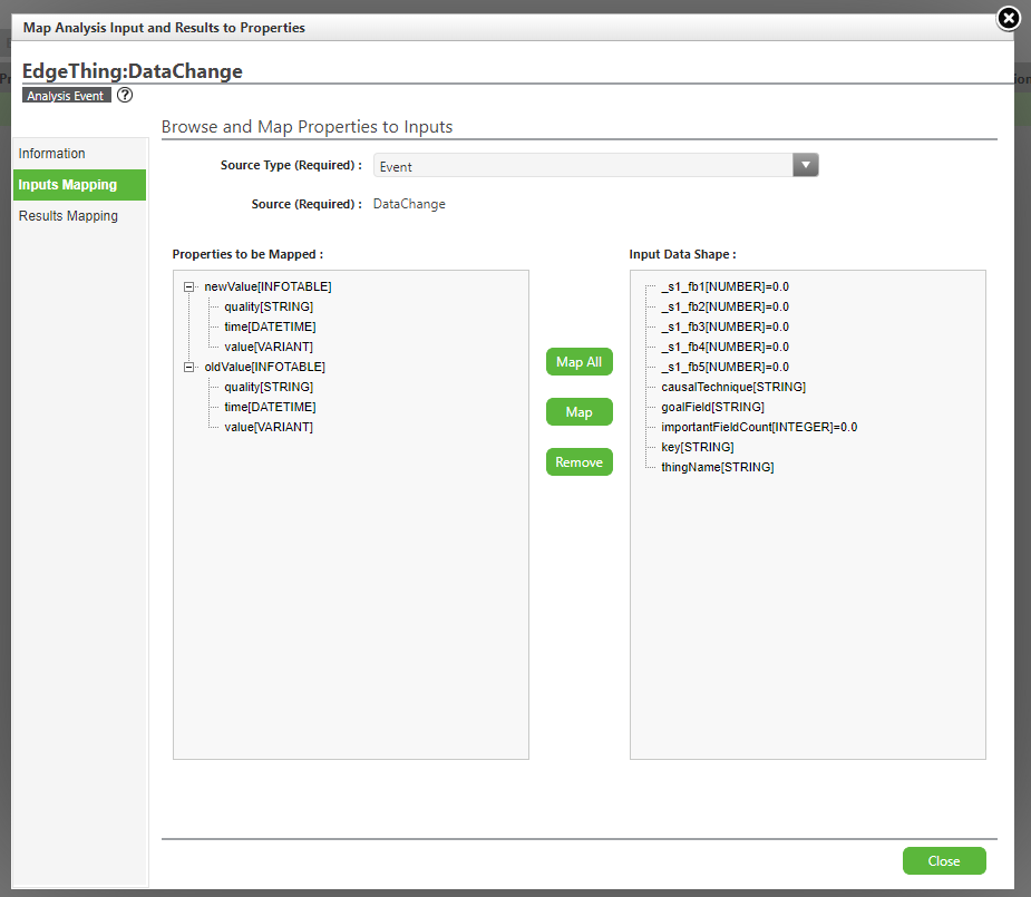

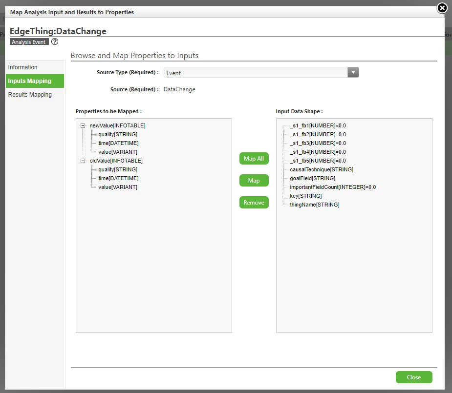

  1. Select the previously-created Event, and click Map Data....
  2. Click Inputs Mapping.
  3. In Source Type, select Thing.
  4. In Source, search for and select EdgeThing.

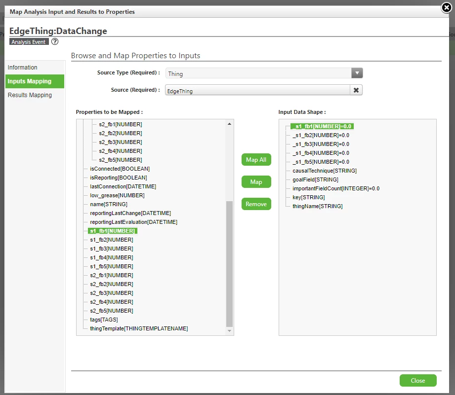

  5. On the left, scroll down and select s1_fb1.
    • Note that you do NOT want the s1_fb1 that is part of the InfoTable Property, because the Info Table Property only stores recorded data, not live data.
  6. On the right, select _s1_fb1, the first frequency band required for the Model to make a prediction.
  7. Click the Map button in the center.

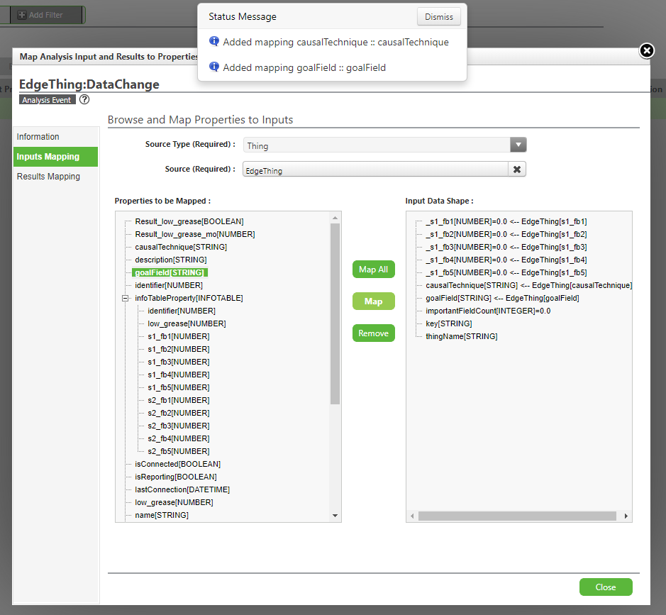

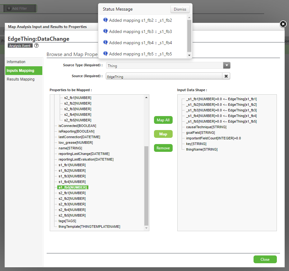

  8. Repeat this mapping process for for s1_fb2 through s1_fb5.
  9. Map causalTechnique to causalTechnique in the same manner.
    • This is a String Property in EdgeThing with a Default Value of "FULL_RANGE".
  10. Map goalField to goalField in the same manner.
    • This is a String Property in EdgeThing with a Default Value of "low_grease".

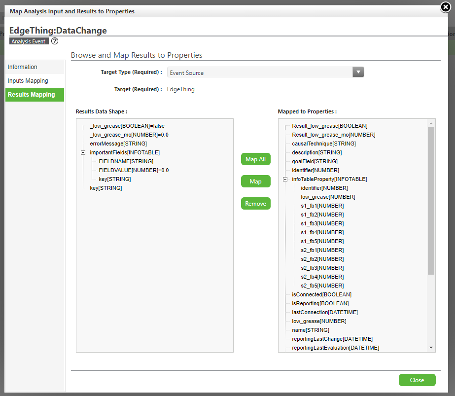

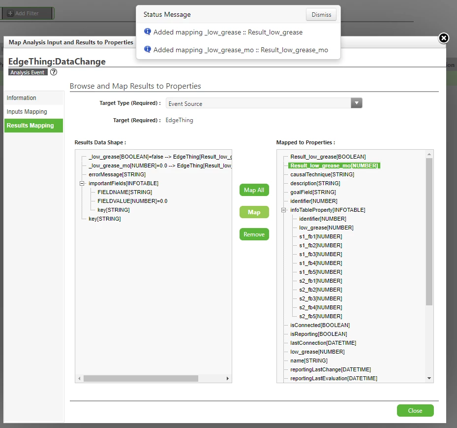

Map Results
Now that the Inputs are mapped, we also want to map the Results.
  1. Click Results Mapping on the left.
  2. Map _low_grease to Result_low_grease.
  3. Map _low_grease_mo to Result_low_grease_mo.
  4. Click Close to close the mapping pop-up.

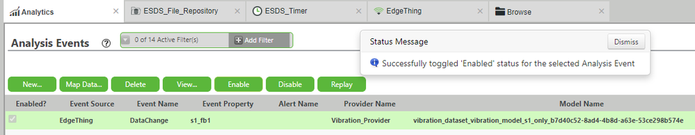

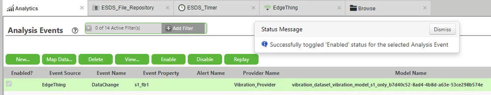

Enable Event

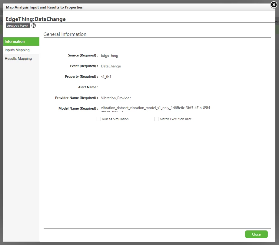

Now that we've done the mapping from Foundation to Analytics, let's Enable the Analysis Event so that it can automatically generate and process Analysis Jobs.
  1. Select the mapped Analysis Event.
  2. Select Enable.
Now that you have enabled the Analysis Event, the new data will be submitted to Analytics Manager whenever EdgeThing's s1_fb1 Property changes.
An Analysis Job will automatically run, with a predictive score sent back and stored in EdgeThing's Result_low_grease (Boolean) and Result_low_grease_mo (Number) Properties.

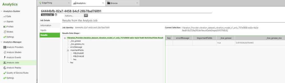

Step 7: Check Jobs
In this step, we'll confirm that the automatic analysis of information coming from remote devices is operational.

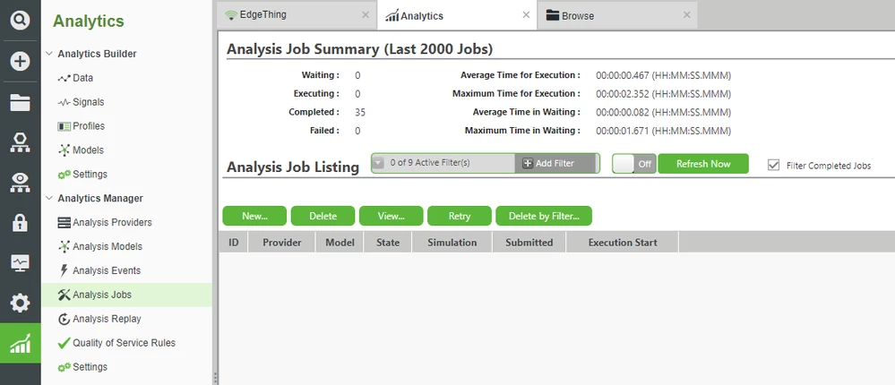

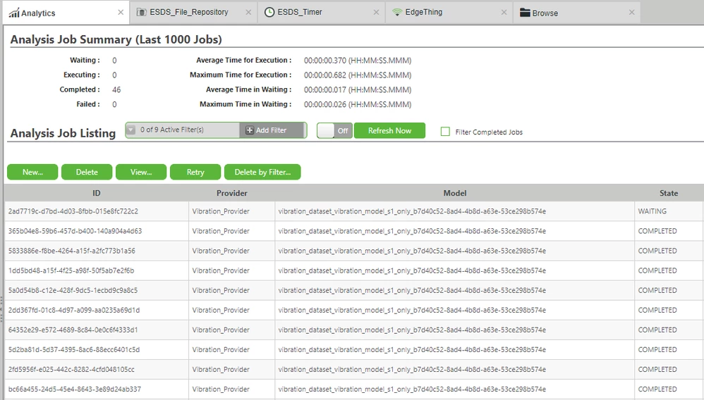

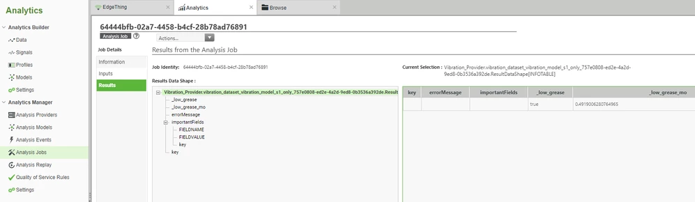

  1. On the ThingWorx Composer Analytics tab, click Analytics Manager > Analysis Jobs.
  2. Uncheck Filter Completed Jobs.
  3. Select a Job and click View....
  4. Click Results.
    NOTE: You will see true or false, corresponding to either a low grease or no low grease condition.
