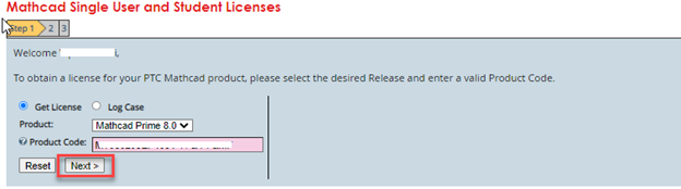

  1. Mathcad Single User and Student Licenses can be transferred by using the link.  Select the version and enter the product code
  2. image

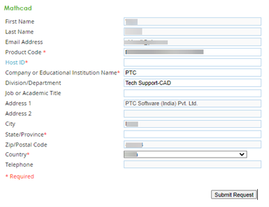

     Enter the new HOST ID onto which the license needs to be transferred
    - To correctly identify the Host ID on new machine, go to Windows Start > Programs > Accessories > Command Prompt > type ipconfig/all (ENTER) and with the Physical Address below the Ethernet adapter Local Area Connection there stands the Host ID
    -  Click on #Submit Request

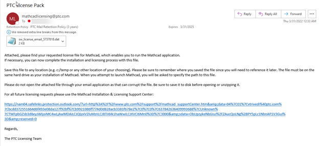

  3. image
    Below is the sample email triggered with new HOST ID license file (attachment)
  4.  Please save this license file to a secure location on your computer.

Sep 24, 2025 5:52 PM UTC
Replying to JM_8857703
Didn't work for me either until I took the spaces out of my product code, then it worked fine and I got my license immediately.
Sep 24, 2025 5:53 PM UTC
I had the same no joy reaction until I took the spaces out of my product code. Then it worked fine and I got my license almost immediately.
