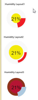

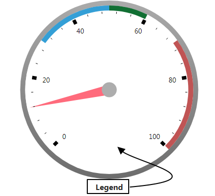

Hi, Thingworx Widget default look like this
and i has two question
gauge_mashup
1. how legend place inside widget?
2. can i make widget design like a picture?
Thingworx gauge customization에 대한 이미지 검색결과
Best answer by sgreywilson
You can create your own widgets see some example posts below for the how
I have created also created  see attached percentpie
Also a very basic Just Gauge usage  see attached just-gauge - The ide layout is not welll defined but shows how to use  justGage.com

if so, is possible make widget style like a picture?
temperature에 대한 이미지 검색결과
Also, it is difficult to know how to attach data and how to design it. Sorry.
January 10, 2018
Just Gauge provides similar gauges  to the ones posted above. Try to use the extension blog mentioned about to understand how create extensions  and take the JustGage primer attached and extend as needed.
If you need help post questions
