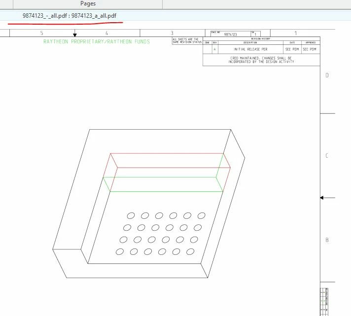

This is now possible with Creo View 4.1 and Windchill. We publish our drawings on check in as .plt's so we can use the Creo View compare functinality which automaticall lines up the two files and color codes the differences. We also need pdf's also of the final drawing when submitting the IR/CN.
dschenken2-ExplorerAuthor
2-Explorer
July 17, 2017
Creo View cannot do this. It can only do a small sub-set; so can PDF compare in Adobe Acrobat.
By .plt, I assume you mean HPGL?
July 17, 2017
Yes we publish HPGL's. If I save the PDF's to my hard drive from Windchill I am able to do a PDF compare in Creo View 4.1. I attached an image of the PDF compare.
