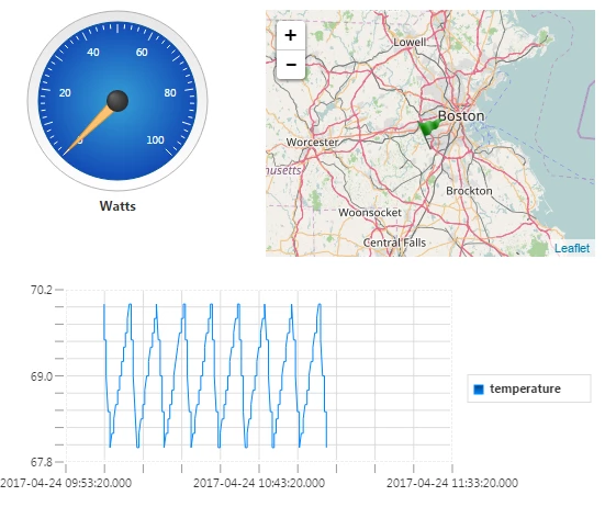

Modify the application model, enhance your UI, and add features to the house monitoring application to simulate a request as it might come from an end user. For this step, we do not provide explicit instructions, so you can use critical thinking to apply your skills. After completing the previous steps, your Mashup should look like this:

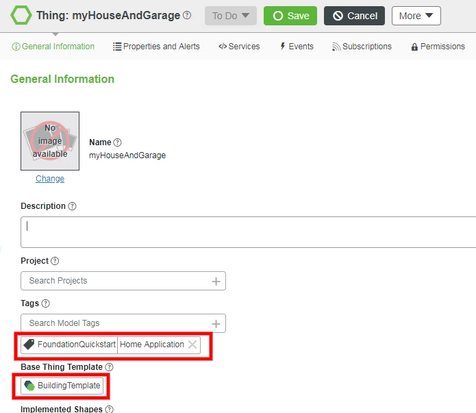

Create New Thing
Creating a new Thing is one way to model the garage door. We explain other methods, including their pros and cons, in the Solution discussion below.
  • Did you create a new Thing using the Building Template?
  • Did you apply a Tag to the new Thing you created?IoTProductMgmt_1-1659630436669.png
    Review detailed steps for how to Create a Thing in Part 2 of this guide.

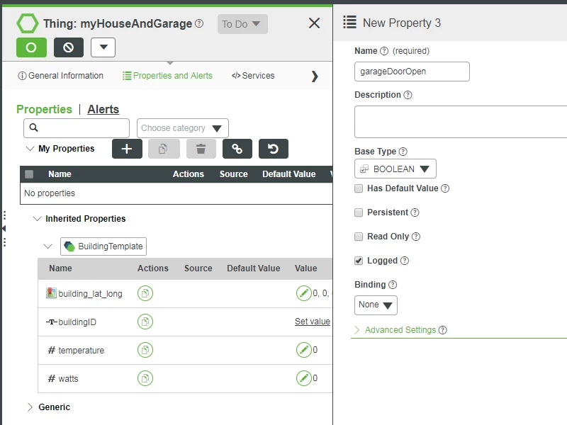

Add Property
Any modeling strategy requires the addition of a new Property to your model. We explore options for selecting an appropriate base type for the garage Property in the Solution discussion on the next step.
  • Did you add a Property to represent the garage door?
  • Did you use the Boolean type?
  • Did you check the Logged? check-box to save history of changes?IoTProductMgmt_2-1659630436675.png
    Review detailed steps for how to Add a Property. in Part 1, Step 3 of this guide.

Property Base Type
We chose to represent the status of the door with a simple Boolean Property named 'garageDoorOpen' Thoughtful property naming ensures that the values, true and false, have a clear meaning. Using a Boolean type also makes it easy to bind the value directly to a Widget. The table below explains a few Base Type options.
