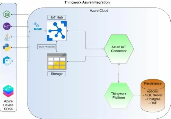

The diagram illustrates device-to-cloud integration with the Azure IoT Hub.
The ThingWorx Azure IoT Hub Connector establishes network connections to both ThingWorx Foundation and the Azure IoT Hub. Data flows in from devices, through the Azure IoT Hub hosted in the cloud, to the ThingWorx Azure IoT Hub Connector configured for a specific ThingWorx instance. The ThingWorx Azure IoT Hub Connector translates messages from the Azure IoT Hub format, to the native ThingWorx format and uses an established AlwaysOn connection to forward the information to ThingWorx Foundation.
