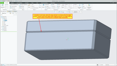

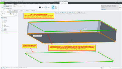

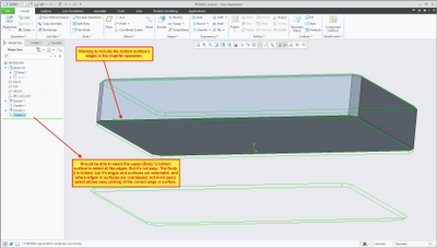

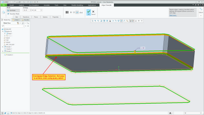

I've found a bug or quirck in using the edge and face collectors in multibody operations.
If two bodies have overlapped edges or faces, it's not easy to individually select both of them.
I've noticed it using chamfers or rounds. It's not easy to specify if the edge we select belongs to
one or the other body, if the edges visually overlap. Not even using Quey Select.
I've tried the obvious solution, of temporarily hiding one body, to avoid overlapped edges on-screen.
But the problem lies that those edge and face collectors presently do not take into account body
visibility. They are shown and are selectable as if the bodies were not hidden.
I think this is a fix that should be included in an update to Creo 7.
lection

Jul 7, 2020 1:46 PM UTC
To be frank, I was uncertain to classify it a sa bug, since I was able after several tries to achieve what I intended to.
If we press Ctrl + right mouse button, to use query select, sometimes we are able to chose the overlapped edge or surface that we want. But it's not easy nor fast way to do it. The issue I have, is that if we hide bodies, we should not be able to select it's edges or surfaces by picking on the screen. I admit that those already selected adges of the previous unhiden body may be still previewed when trying to finish the command (in this case, a chamfer), but we should not be able to unselect edges or surfaces of a body that is not visible on the screen. The previews edges or surfaces of the hidden body should preferebly be previewd as "read-only" selection, and no be able to unselect them, unless we unhide again the body where they belong.

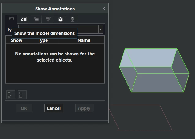

Creating a new part from a body is a beautiful thing.
This new part contains an external copy geom.
I expected to be able to display the generated dimensions of the original body in the new part. But I have not managed it until now. It says "No annotation can be shown for the selected objects"
Is this really not possible - or have I just not found the way yet?
Best regards
Uwe
Oct 28, 2020 8:30 AM UTC
A geometric copy does not copy the feature information over to the new part.
As such there is no way to show feature dimensions in the extracted part.
If you create an annotation feature in the source part that holds the dimension that you want to show in the extracted part, then you can re-define the external copy geometry (if you have the AAX license) and tell it to bring those annotations over.
7-Bedrock
Oct 28, 2020 8:46 AM UTC
Many thanks for the clear explanation of the matter.
Now I do not need to look any more ...
